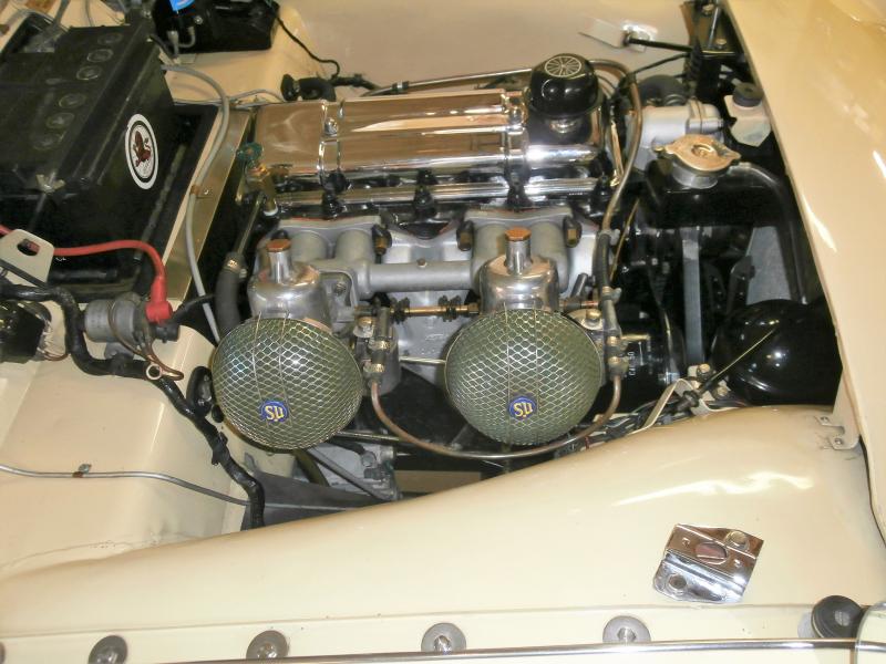

Here's the engine bay end on late TR3. I believe the cable shield was black on a TR2 My engine bay2019-L.jpg
R
Redoakboo
The cable is the grey cable running along in front of the battery and then through the hole in the firewall? I assume it's routed from the transmission with clips up the inner fender?

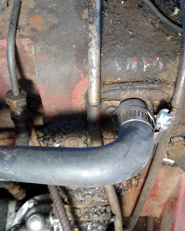

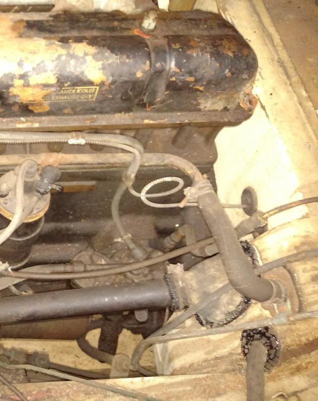

Ill throw a different opinion out there. Here are two Tr2s, no OD, that have a different routing. The red car is TS 5265 found in very original condition and the white car is TS3285 also in original condition.
Graham H
Different route altogether for non overdrive, if you look at my photo you can see the brake pipe going forward and through a large grommet in the chassis , the speedo cable goes through the same grommet then up the firewall across in front of the battery box and through a grommet behind the speedo.

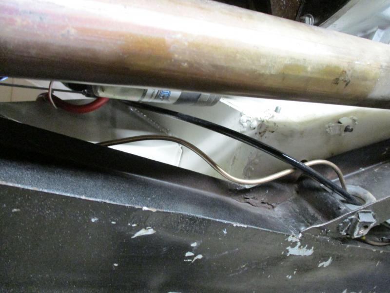

OK...as promised. I am using my pre-build photos, so you have more definition. But here goes the entire run...
So here we start with the end of the cable where it plugs into the OD tail section. It comes straight out, under the floor where the handbrake boot is located and curves forward.
Now you see it passing through the section of frame with the brake line (and grommet as everyone mentioned. This allows it to come back inboard towards the starter.

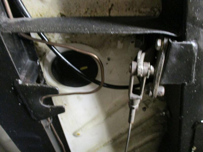

Here it is along the starter. Time to add the body to the pictures....
Here the cable is held with a brass clip to the firewall, very close to the tunnel. The screw is the same one that holds the RHD steering column blanking plate. It is now going to turn across the firewall to the driver's side.
Another brass clip at battery center brings it over to the driver's side.
And to wrap up the run, it turns and enters the pax cabin through a grommet right in front of the speedo.
Hopefully this will clear it up!
