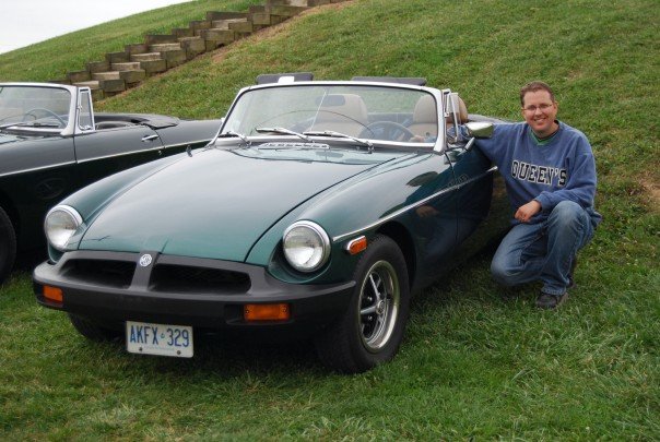

I'll start with a before picture from this year at the MG Racers meet at Mid-Ohio. So far I have taken the bumpers off and cut the brackets back.

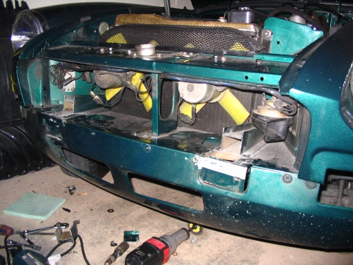

I got the bumper mounts cut back nicely. I'm leaving the lower half of the mount on for now until I figure out positioning for my Lucas driving lights. I may end up using a portion of the mount and will cut the rest off then.
Besides the obvious grinder, cut off wheel and reciprocating saw, one handy tool for this job is a old school hacksaw - the type where you insert one end of the blade into a handle, and the other end is free. Coudln't have done it as cleanly without it.
