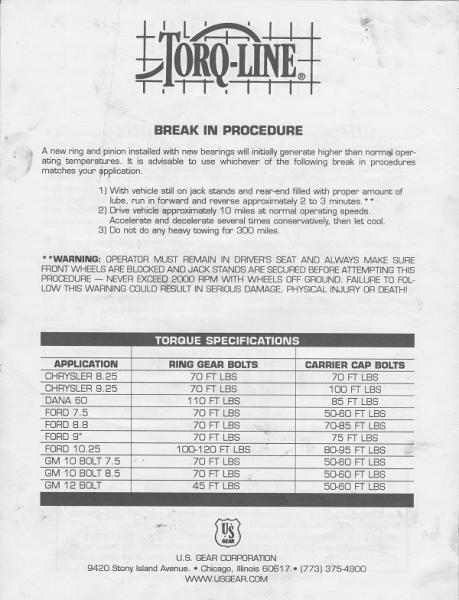

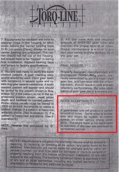

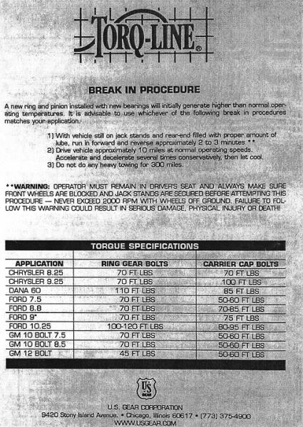

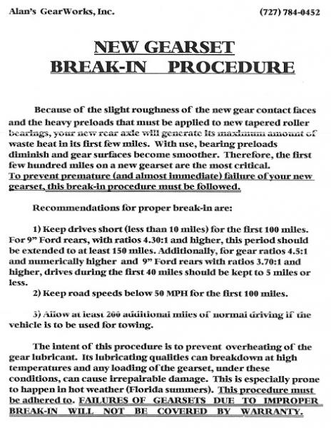

"Noisy" is subjective (see the red rectangle in page 3 of the attachments). I bought a 3.54 gear set from Mike Lempert's first production run in 2002 and had it set up by a shop in Florida that Mike recommended (Alan's GearWorks). When I got the pumpkin back, it came with break-in procedures from both Alan's and the manufacturer (U.S. Gear Corp.) that are critical to good performance. I followed the break-in instructions exactly and have never had a problem with the 3.54 gears in 71K miles, although I do believe they are a bit noisier than the original 3.909 gears with the top up. But the noise is not objectionable and is not noticeable to me with the top down, except when passing something reflective like a semi or a bridge railing. I agree with the recommendation to drain the oil and inspect it for anything that appears abnormal (metal particles, burned smell, etc.).

B
bdcvg
The break in driving Tom executed before He shipped the car to Me was very close to the described procedure. Maybe I just don't remember the volume correctly. I will swap fluid next week anyway and examine for metal.

Here's the instructions that came with my Lempert gear set:
Don't know where I got the '500 miles' fluid change; probably heard it somewhere. I don't think there will be much swarf from the breakin, but the oil might be degraded from heat and shear.
