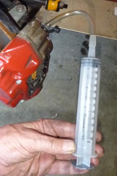

I've had good single-handed bleeds with an inexpensive brake bleeder syringe from Amazon:
Sealing around the bleeder threads either with grease or teflon tape.
Mike Salter told me once that there was a BJ8 he was only able to bleed by forcing clean fluid upstream from the bleeder screws.

Thanks again everyone. Brilliant suggestions. The rubber hoses are new. I tried with a syringe made up a fitting for the blender thread. I seemed to get lots of air so it think the thread may have been leaking. The fact that clamping the rear hose makes the brake pedal hard seems to mean it's the rear brakes. As I said, I have ordered new shoes. They should be here next week. Hopefully that may make a difference. If not I'll just bleed, bleed, bleed!
