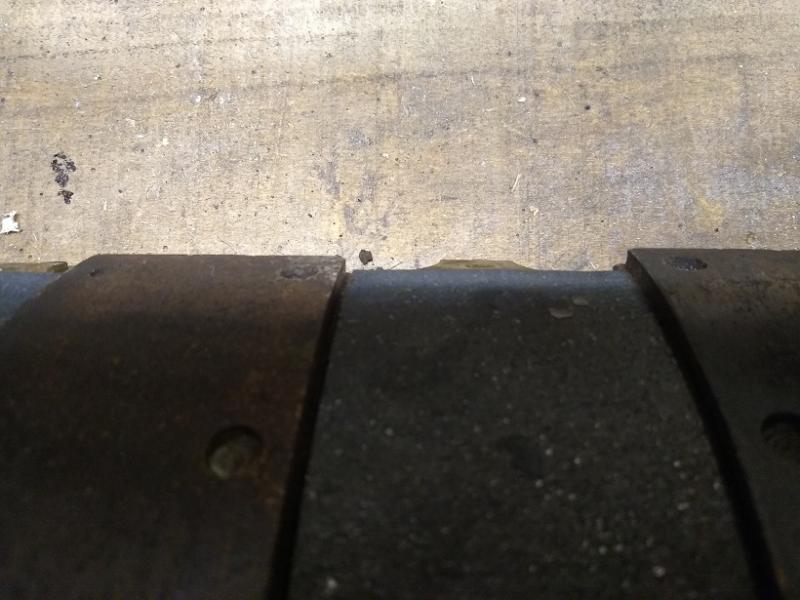

I believe this picture demonstrates the variables found in the geometry of many drum brake systems. Not much different than the little bit of metal that I added to the shoes to make the repair. As a matter of fact the repair I made probably improved the geometry.
