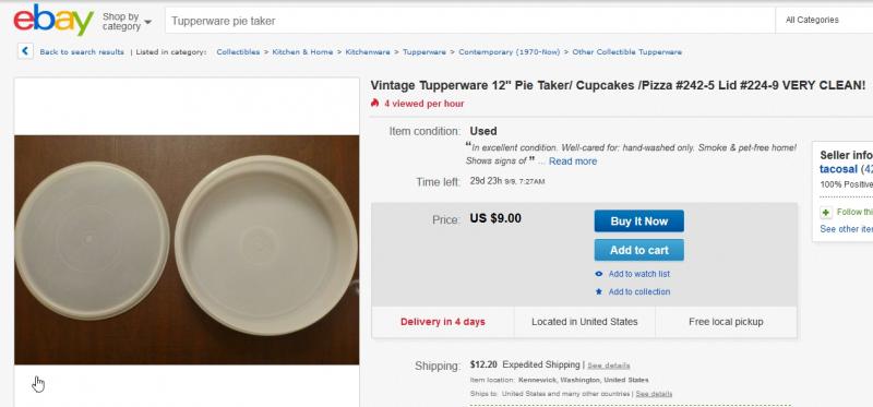

Somewhere on the forum I saw somebody using a 5 gallon bucket cut down to a height the fits under the spare. It makes great use of space previously unused. I just happened to have a black bucket so You can't even see it. It holds quite a bit of spare parts and tools and doesn't bounce around.
steveg
If you can find one, a vintage Tupperware Pie Taker works well in the spare:
