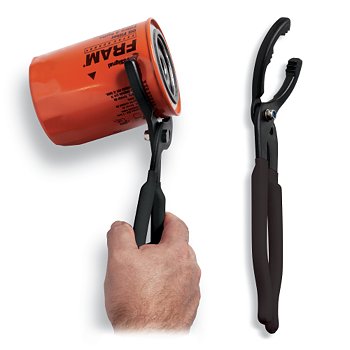

Does anyone use a particular type of spin-on oil filter wrench that they like?
I bought one of those cap-types that I pre-fit to the filter and it worked for a while before just spinning on the head. I probably need the next smaller size, but I thought I would ask.
I am thinking about this one.
Thanks!

I think over the years I've tried almost all of them except the one shown in your photo. The main problem is on some cars there's a lack of clearance for the type shown and the cap type or a band type with a swivel head is about the only thing that will fit, such as the one pictured from K/D tools. I have noticed that any tool that doesn't spread the force equally around the filter tends to colapse the housing and then it's a real pain to remove. That's why I tend to use a band type tool. Even a chain or strap wrench tends to apply force to an area just under the head of the tool and can push in the side of the cannister.

:iagree: with Bill....plus, yours looks like it might punch a hole in the filter if compressed too much...that'd make a mess in the engine compartment/garage floor.

I guess I'm on the other side; I mostly just use some big slip-joint pliers and let them crush the can a little. Doesn't seem to hurt anything, it's not like I would want to try to use it again. I've got several of those band-type things, but never seem to pick up the one that fits.
And on a Triumph, you're going to spill some oil anyway. If the can does get punctured (which in my experience is unlikely), it just spills more oil into the catch pan.

Being a pro technician I get to try and remove the filters that all the gorillas that work at the jiffy lubes torque down to oblivian. I have 2 of those "pliar" type wrenches. a big and a small. they work very well on most cars. Yes they crush to filter a bit, but I've never had one poke a hole. The other one I have is an expandable cup type. there are two "ears" that tighten togeather as you turn the filter off. that one works well on a lot of forign cars. Toyota, Subaru, and others where you can get a straight shot but it's up in there a ways. but it won't work on badly overtorqued filters.
