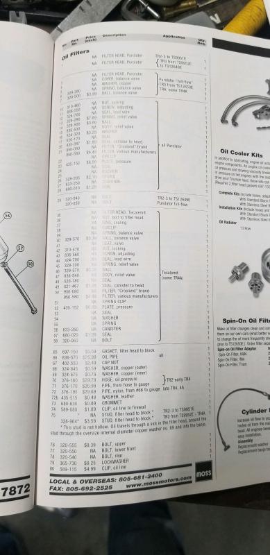

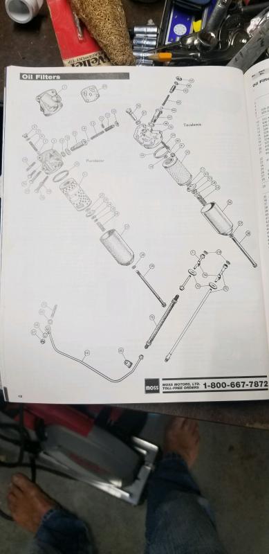

There are PDFs of the parts book out there on the internet. This is a good place to look or parts drawings. https://mossmotors.com
It may be difficult to get the original style of filter from the local parts stores. A lot of people convert to the spin on filter.
David

The canister consists of the following parts:
The can itself.
The long through bolt.
A rubber seal in the bottom.
A spring that holds both the seal and the:
Large washer pressure plate.
A wire clip to hold all the parts in the canister, so all the above comes out as an assembly.
It sounds like all your parts are there, but the clip broke or came loose. I would have to see pics to verify, though.
Also, the block the filter canister mounts to also has a square o-ring seal, which is frequently forgotten. The result is one or 2 get jammed home in the groove, so eventually it turns hard and has to be dug out with a pick. Be sure to double check that there are no old o-rings in your groove.
