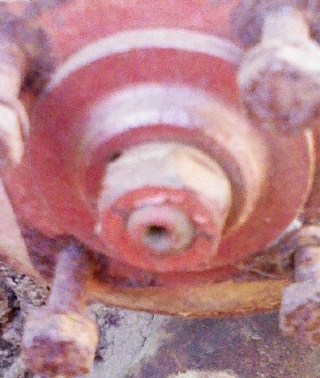

Is this the nut in question? I took my antique alloy prop blade off to ensure I didn;t end up with a hole in the shroud!

Hey zblu,
That's the guilty subject ! When you took the old aluminum fan blade off have
you just left it off with no fan blade ? As I mentioned, the previous owner
of 30+ years took it off and never put back on and did not have over heating
issues. If he was in a parade or something he would turn on the aux electric
fan mounted in front of the radiator which is still there and working. Michael
O'Brien above mentions a hot climate fan which I might look into.

zblu
Mike,
The pic is of a spare block, it shows a washer behind the nut, I have 2 ali propellors for lack of a better word! sitting on the shelf
I replaced it with a 5 blade unit similar to the texas cooler, (at least from memory its a 5 blade)due to the fact the original is now over 50 years old and may be prone to self destruction!
