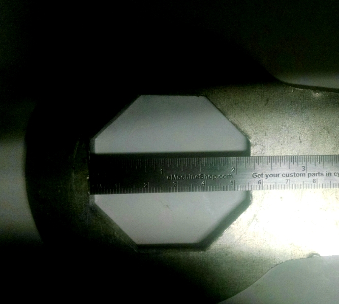

I had ordered one of the then commercially available stamped tube types, but delivery was long in coming, so I made this one to get the job done. Once the store-bought piece arrived, I was not impressed with its quality, but a member here was still willing to take it off my hands.
I continue to use my homemade socket...
I don't remember the dimensions I used__I scribed the nut's outline onto the blued steel block__before whittling it out with an end-mill cutter, but Michael Oritt claims it's a 2-3/16" and John Turney says a 56mm fits (his Metric socket was sourced from AH Spares). In any case, just make sure it's an eight-point socket (for square or octagon-shaped fasteners) or it won't work.
Note: I would've bought a conventional forged steel socket, had I been able to locate one, but even all the machine-tool suppliers I frequent had none listed for this size/configuration.

I believe it is 2 3/16" . Borrowed the socket--it's the size of a tea cup--from a fellow club member. Also borrowed the 1" ratchet and extension to go with it. Happily, didn't need to use any of it.

I use the box spanner type sold by AH Spares. IT IS STAMPED 2-13/64 and a 3/4" breaker bar, it works for me, but I want to install a mandrel into it to fit up into the axle tube to give it stability as the nut is very thin. I have the steel to do it, along with the anvil section that also fits up the axle tube for the hub puller to bare against, but just lacking the will at the moment.
