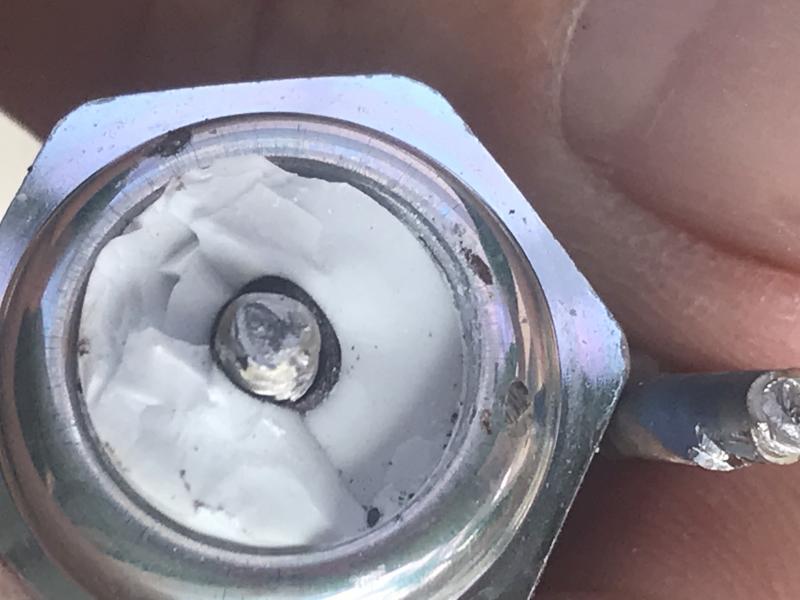

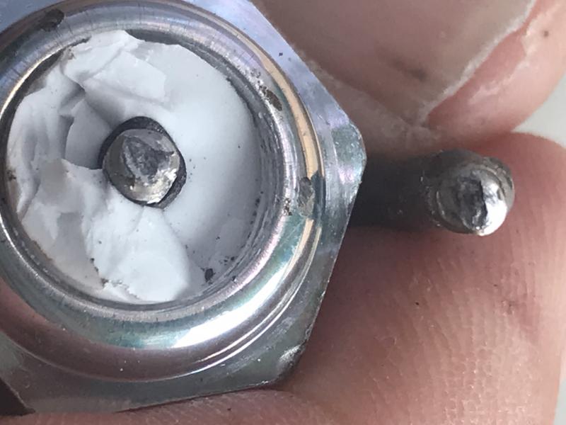

After looking at the video at the link below, the quality of the fake plugs from Amazon was much better than the earlier examples.
http://www.ngk-sparkplugs.jp/english/techinfo/fake/index.html
One might need to buy a 7th plug and break it open to see if there's a copper core.
I wonder if there are any fakes of the standard copper-core plugs we're using. They seem to be in the $4.50 range. The fakes shown are $10+ Iridium plugs.
steveg
Steve,
If you look at the Denso ad in the thread I posted, they note that their are counterfeits of their copper core plugs that use iron instead of copper. I'm guessing NGK probably has the same problems
Yeah, that's why I was suggesting buying an extra plug to break open for the iron core.
longbridgehealey

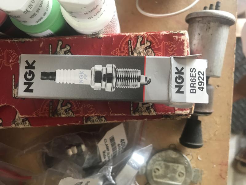

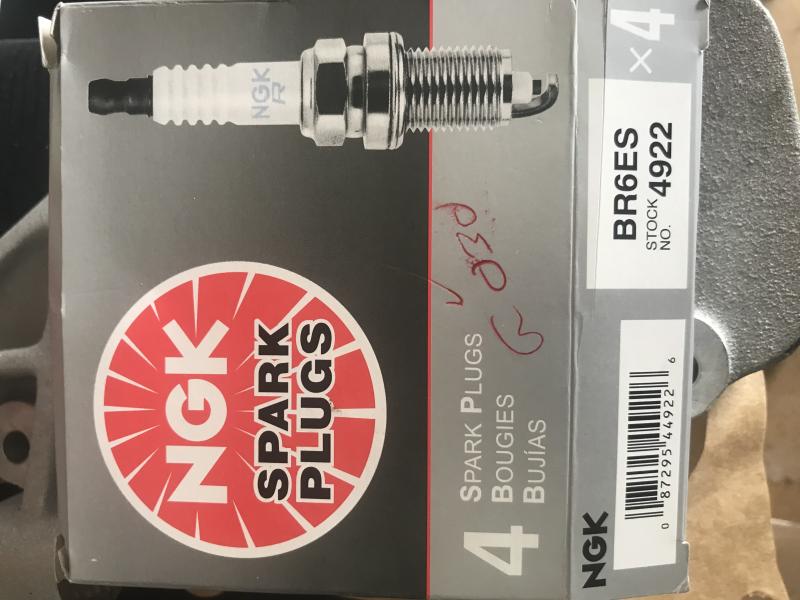

Bought these a week ago on amazon, bought 8, need six, broke one apart.
