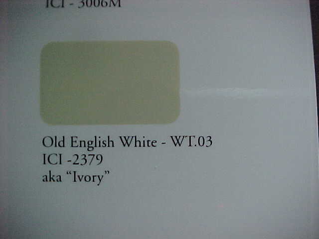

davidb, dont believe every thing you hear, or read by anderson and moment, though very helpfull they are human and do not know everything about healeys, here is the color "white" aka "ivory" for bj7 feb. 1962 to nov. 1963 and bj8 nov. 1963 to dec 1967.

Thanks for the comment.
Sources notwithstanding, based on our collective research, I guess the bottom line is that Old English and Ivory are in fact the same color using the ICI code.

Thanks guys, I would have responded back quicker, but we had some pretty mean storms come thru this week and take out the cable sever here. All is back on line and going. Will compare this code to whats on the can of paint I have to see if it is the same. What I have looks whiter. Going to try to make the car look like the Peter Jackson racer photo that was posted on BCF a couple weeks ago.
