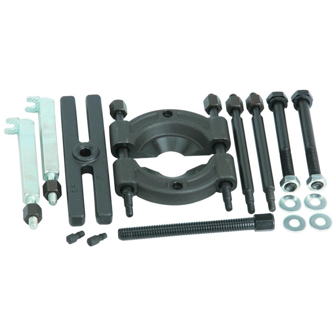

You're working on the crankshaft, not camshaft, correct? It's within the range of 'normal' to have to tap it into place, IMO. To remove, use a gear puller with a bolt threaded into the end of the crank (for the forcing screw to bear against). I had to pick up some coupling nuts to extend the legs of my cheap HF puller.
