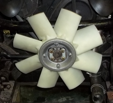

I've asked Macy's to explain their installation instructions, but I'm anxious to get this car back together and drive it.
The kit has eight rubber grommets and four steel sleeves to put into the fan hub and spacer, plus flat washers, and two locking devices. I can't seem to get the rubber grommets and steel sleeves put together with the fan and spacer - they are really a tight fit. I first tried WD40, then putting the rubber grommets in hot water, no go. The whole unit put together is too thick for one of the locking devices (the one with the hexagonal hole) to work. As per the instructions, the fan is thinner than the stock fan, thus the spacer, but it goes in front of the fan, why not use shorter bolts (but it doesn't appear that the bolts will stick out too far in the back of the fan extension.
So - who has put one of these onto a TR3/4 engine and can explain how to do it?
Thanks, in advance,
Tr3aguy
Does the picture help?
jfarris
jfarris
Not really JP and the diagram in their instructions is of a stock fan, not the installation of their kit.
The fan is very high quality, just having a problem deciphering the instructions to install.

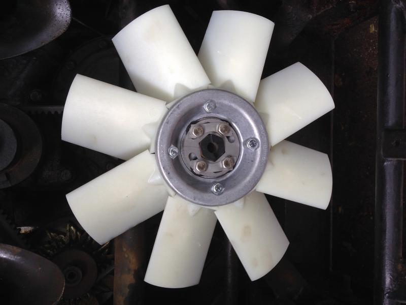

I have one on my TR3, I don't recall having any issues. I'll look for pictures.
The installation of the Macy's fan, in my opinion, is one of the most functional upgrades I've done to my car.
Bill
TS63273L
BillyB62
Does this help? I've got a couple more of the installation if you send me your email address - but most are similar to this.
jfarris
jfarris
Bill,
You can send pictures to farris.jd at gmail.com - thanks.
My problem is getting the rubber grommets and the steel sleeves to all fit in both the fan hub and the spacer. It appears that the grommets go in from the back of the fan and the front of the spacer and meet in the middle with the steel sleeves spaced in the middle, not extending to the end of the grommet at either the back or the front, ie the length of the two grommets together is longer than the steel sleeve that goes inside of them. They are all such a tight fit that I can't get them all to the correct place at the same time. Like I mentioned, I've used WD40 and also soaked the grommets in hot water. I included a very rough drawing as to how I "read" the instructions that they fit together. Any help is welcomed!
View attachment Hurricane fan.pdf
jfarris
jfarris
Eureka! I got a great email from Macy's explaining that they use Moss parts for the rubber grommets and steel sleeves for the fan. The sleeves are good for the ID, but a shade bigger for the OD, thus my difficulty putting everything together. I used the original steel sleeves for the fan and it went together in 10 minutes versus the three attempts taking a total of about an hour. That allowed me to get the radiator in and start the car after four months. I'll hook up the throttle linkage and choke tomorrow and may go for a drive in the neighborhood - the front apron is not on yet.
