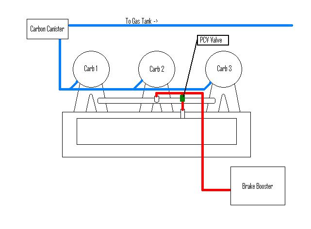

I'm trying to diagnose a fast idle problem. My carbs have been rebuilt and I've got the timing set at 8 degrees ATDC (I have a Mallory dizzy without the vacuum advance). Anything over 900rpms and my engine diesels badly. So my first inclination was to lower the idle speed, only the idle screws are backed out completely. So I'm thinking that I need to take a close look at the way I've got all my vacuum/emission lines set up. I've made quick diagram that details how I've got things plumed. Is this correct?
I'm pretty sure that I don't have any vacuum leaks. Since I've got the Mallory, the vacuum plug on the bottom of Carb 3 is plugged.
Please see attached file for the diagram.

Hi Shannon,
In that diagram that you posted you show the PCV tied into the vacuum supply line for the brake servo. Is that a correct illustration of your setup? Have you driven the car this way?
Do your brakes feel like they function properly?
I am no expert but it is my understanding that the vacuum supply line for the brake servo should be only hooked up to the brake servo and not trying to supply vacuum to anything else.
You may try and remove the PCV Tee from the servo hose and connect it to the blue hose in your diagram which terminate at the carburetors. On my stock '74 the pcv is connected to the carb ports which are located before the throttle plates. This is done, I believe, to prevent an unwanted introduction of fresh air into the fuel/air charge thus leaning out the mixture. The fresh air can be drawn into the engine case from any number of places (small leaks in gaskets, oil cap etc)and then almost immediately be drawn into the intake as per your drawing. If you have it connected to the carbs that air can now be accounted for and the mixture adjusted accordingly to compensate. Also, if you have the lines connected in the manner you show I think your brakes might be weak. Moving air takes the path of least resistance and in the setup you show all of the air drawn into the intake will most likely come from the engine case and you will not have adequate vacuum at the servo.

Hello Shannon,
although probably not the cause of the high idle; you have a non standard distributor but set very retarded (8 deg ATDC), what is your total advance? I suspect that you will need a lot more advance for the car to run well.
Do a double check of the throttle synchronisation, if you can get a reasonable idle speed (600 - 700 is good)with the carburettors independant of each other then there is a synchronisation problem the way they are presently set up.
(Don't forget the choke idle speed screws also)

Hi Shannon,
I have to agree with Roman here. The line to the brake servo should be uninterupted. The valve cover line should plug into the lines going into the carbs that also attach to the charcoal canister. In my tri-carb set up, R.G. supplied a four way connector for just that purpose.
If you have more than fumes coming out of the valve cover then there are other issues. The cast aluminum valve covers are not baffled like the factory steel covers. With the tri-carbs, I had a lot of oil being pulled out of the valve cover and through the carbs. That is one of the reasons that R.G. came up with his oil seperator set up. It was never an issue for me with the twin carbs.

Ok, I took the crankcase ventelation hose and spliced it to the line going to carbon canister and drove the old girl to work this morning. She idled at 700 rpm like a champ. Brake pedal feel is much better too. The best thing of all is that the run-on is gone!
