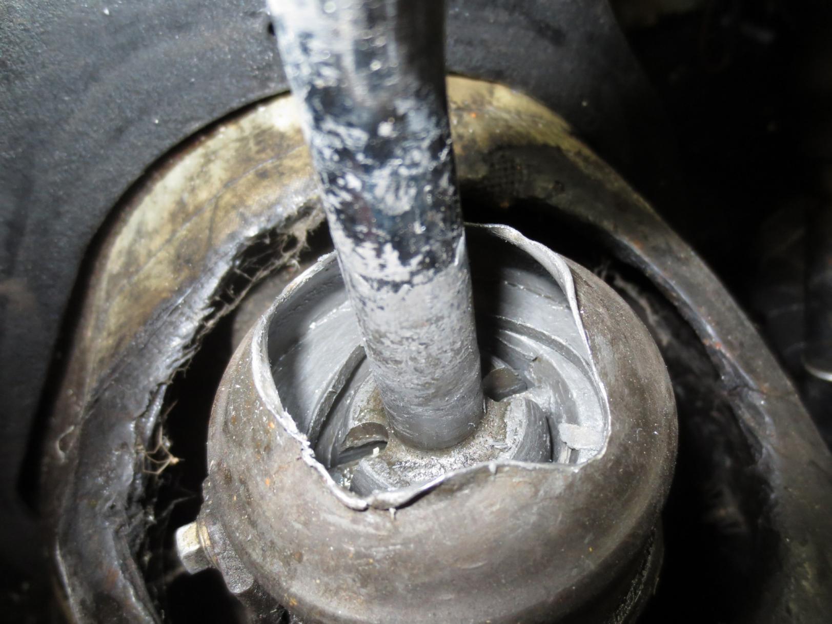

As some of you may know, I recent revived a long-dormant '62 TR4. While the transmission has all of the right gears in the right places, the reverse lockout does not work right. I assumed it was a broken spring since there was no resistance to pulling up on the shifter, but worked right otherwise. I took it apart tonight and what a mess I found. :mad:

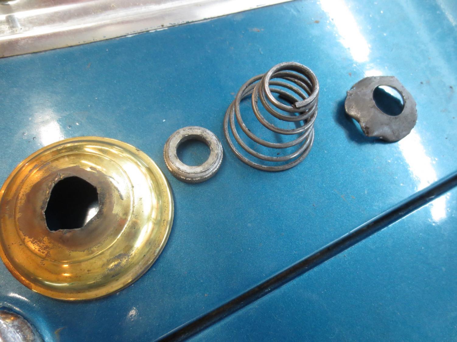

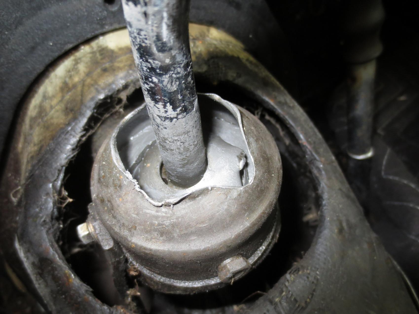

Obviously, a previous owner got "creative" in trying to repair it. First pic is just after removing the spring. Second is after I fished the small metal piece out, last is all of the garbage I found under the shift boot. From left to right, what looks like an escutcheon for a house door knob, a bezel screw for a universal ignition switch, the spring (is it even the original?) and finally, the hunk of metal I fished out. I looked at the Moss catalog, but unfortunately, most parts are tiny drawings of parts that are unavailable anyway. WTF is this mess supposed to look like? Help!

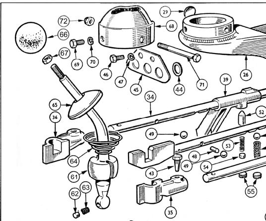

Spring looks probably original to me. Here's the drawing from the SPC, might give you a better idea of what it should look like. For sure, you'll need a new cap (105787, NLA AFAIK) and retainer (112442, $10 @ TRF).
