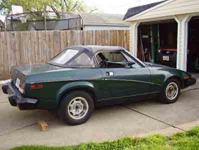

Supposably it's been garage kept and all I have to go on now are the pics they sent and it looks solid. However until I put an eyeball on it then I'll know for sure. No pics of the engine compartment so I couldn't see the strut towers. He's asking $2200.

Keep us posted, and throw some pictures up here so we can help take a look.

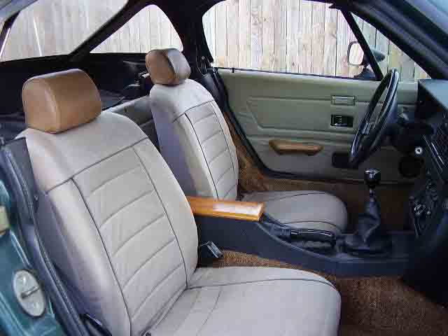

I'll post a few pics. The first on is the interior. The car is dark green and the door vinyl is gray?

Mickey Richaud
Interior's definitely been changed. Should be either tan plaid or tan cloth (probably plaid).
As for structural issues, take a look at the floor behind each seat. The rear links are connected there, and if those areas are compromised, it's trouble. Also, check under the master cylinders; leakage can spell trouble as well. And one other potential problem area lies along the area between the outboard front corners of the boot and the rear scuttle.

The door vinyl is correct, just very faded. has seat covers on, so I would assume bad seats. I have 2 tr7s that I bought in similar condition, I paid less than 750 for each. IMO save gas, keep looking.

FIRST....check for rust in the trailing arms where they attach to the body behind the seats. That is a difficult repair. Any rust anywhere will be tough to fix and remain within the market value of the car.
That interior picture is pretty scary. My observations:
1. The door panels are incorrect for a 1980 car. They should be plaid.
2. The seats are way wrong and should be matching plaid with the doors. If those are seat covers...pull them back. I suspect a a scary sight.
3. Based on the door pulls, center arm rest & carpet it looks like this was a tan interior car.
4. The boot around the hand brake should be tan as should shift gaitor...they are black....?
5. The carpet looks pretty scary.
6. The 1980's had gray interior plastic bits. The picture looks like they are all black which was pre 1979 I thought.
7. Stick shift is still original height....most of us cut those down an inch or so. :smile:
8. My guess is that car came with a tan top...not black.
9. The outside mirrors are not even close to the originals
10. The wheels look wrong for a 1980. It should have the magnesium wheels, not the pressed steel wheels.
....have you considered looking at a TR8? I know they are more money, but they are a completely different car to drive & repair.
Here is a picture of the interior from my 1980 TR8 as a reference to compare against the TR7 interior... Mine is completely stock save for the radio:
1980 TR7 Interior:

That's a 1980 TR7 Spider....and that is what the wheels SHOULD look like on the 1980 car being considered.
