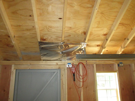

Friday update. Noon here in eastern Connecticut. Here's the garage enjoying the sunshine:
Here's the test patch area of generic kitchen aluminum foil: 1 - shiny side toward roof, 2- shiny side toward interior.

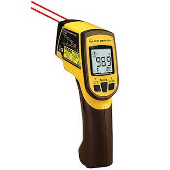

I used laser gun to measure surface temps.
Underside of roofing: 122F
Underside of "dull" foil on left: 85F
Underside of "shiny" foil on right: 92F
Looks like the foil idea works better with shiny surface toward roofing. Either way, seems a definite reduction of infrared radiation compared to the bare roofing underlayment.

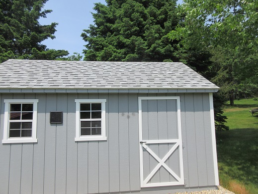

Thanks Mike. Already have roof vents, so my main concern is the heat-up of the MG parked inside, due to the heat radiating from the underside of the south-side of the roof.
When I did the actual temp measurement, I had sprayed flat black paint on the foil, so reflectivity wouldn't be an issue on that laser beam.
So far, seems that the foil is a better choice than lots of insulating material. I don't heat the garage, or cool the garage. I just want to keep down the temp of the car.

With apologies to Mick Jagger, painting it black defeats half the purpose of the foil.
They recommend the shiny side down because the emissivity (the material's tendency to give off heat) of the shiny side is lower and will re-radiate less heat. By painting the surfaces you make the emissivity the same, and very high, near 100%.
A better way to perform that experiment would be to leave the foil bare and place a black object underneath it (but not touching it), measuring the temperature of the object, not the foil.

Thanks. So you'd suggest I put a black object below the bottom surface of the foil, then measure the temp of the *top* of that black object, right?
I sprayed a small area on the foil, as I know that laser (infrared) guns don't get a good reading from a shiny surface.

.... So you'd suggest I put a black object below the bottom surface of the foil, then measure the temp of the *top* of that black object, right?....
Yes.
...I sprayed a small area on the foil, as I know that laser (infrared) guns don't get a good reading from a shiny surface...
That's correct (except technically, the laser is just a spotting guide. The actual measurement is made by a sensor that's looking at the surface. It can't see the laser but they're aligned together to make it easier for us to aim where the sensor is looking).
Most IR guns assume emissivity is fairly close to 100%, maybe 90ish%. The more expensive ones are adjustable. But some surfaces, especially metals, can be far off from that. And shiny metals can actually be so reflective that they act like a mirror and you end up measuring the temperature of a reflected image of some other object in the area.

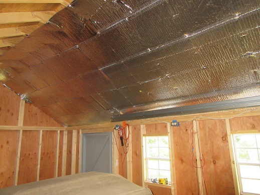

Update. I put Reflectix on the underside of the roof rafters, only on the south (sun facing) side of the roof.
Yesterday at noon, cloudless day, outside temp 91.
Underside of bare roofing without Reflectix: 123 degrees
Underside of Reflectix: 85 degrees.
That is progress! MG doesn't get nearly so hot as before.

Thanks Tom. I've got roof vents in there, but they don't have any effect on the radiant heat from the roof itself. That's what was heating up my MG parked inside.
So I cut down the radiated heat. The convective heat is still there, but escapes through those roof vents without building up inside.
