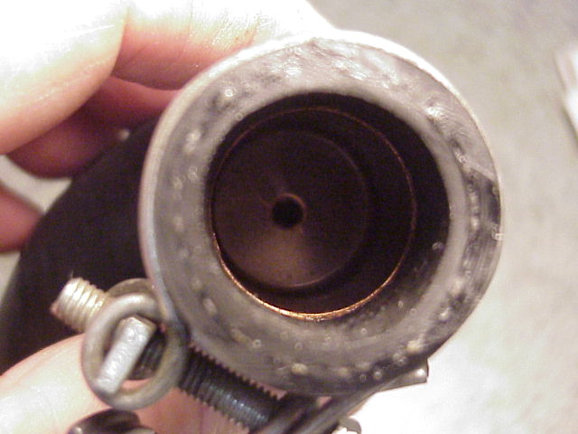

Karl - As I recall it's a ¾" cap with a 3/16" hole.

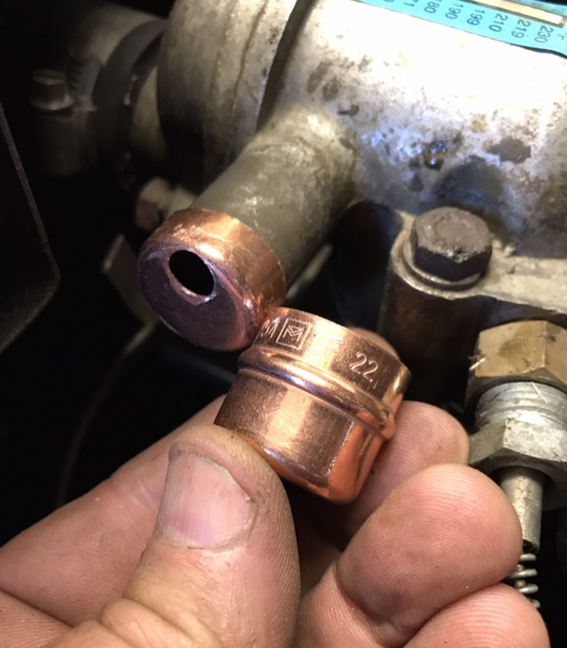

I did this mod
It allows the engine to warm up better in more temperate climates. As once it’s up to temp the thermostat kicks in and regulates as normal. As has been mentioned without the sleeved bellows thermostat with the blanking parts.
I think the casting holes in the later tr4/a cars is smaller so triumph had some learning over time.
I used a 22mm plumbing end cap that the hose fits over.
Hole intentionally drilled at the top for air bleed reasons.
Does no harm.

I did this mod
Does no harm.
Is the air bleed hole abouut3/8"?
