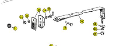

Two questions about the straps for my BJ7.
1) The Moss catalog (21 in pic attached) shows a plate behind the mount that attaches to the boot wall. My mounts are fine but I don't have plates. What is the plate material? Steel? Cork?
2) One of the Ts on the strap is broken off. I was thinking about brazing a bolt on the end of it. Does that sound like a sensible fix?

I see Steve. It goes to the back side. Makes sense. Is it about 1/8" thick?
R
RestoreThemAll
Perfect! Thank you very much.

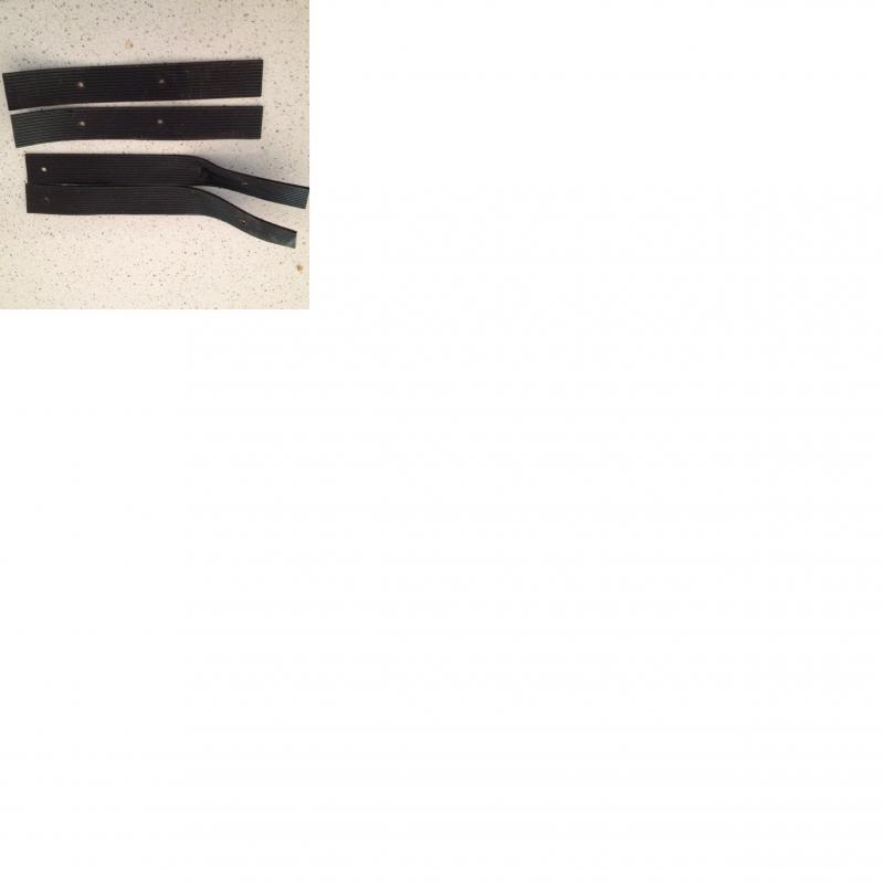

The material riveted to each strap is a thin strip of rubber. I am not quite sure of the rivet type but will check tomorrow and let you know.

I noticed in the comments section that one Healey owner had rubber strips under the straps the same as mine. Mine is a BJ7 so maybe they changed the material later. Just on my way to get the straps out of storage.

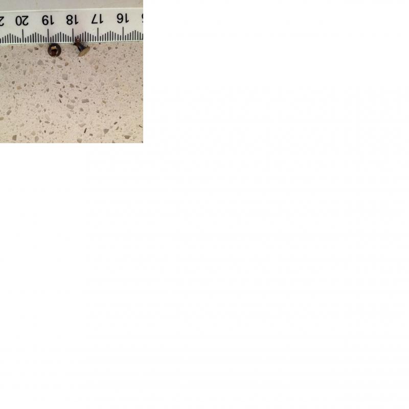

The rivets on my strap are copper bifurcated. I have taken some pics on my phone and will send them to you shortly. I am still not quite sure if the rubber strips are correct as the straps have shorter marks on them where something has been removed . The straps and the rubbers etc. are currently not together.
grimes6
Photos as promised. The rubber strips look professionally made but I couldn't be 100% that they are original . If you search for "fuel tank strap" on this forum you will find a previous post which discusses this item. The ruler is metric.
