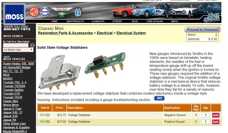

Better idea - Moss makes a solid-state voltage stabilizer used in newer Brit cars. See:
attachment.php
I will order one of these and report back on how it works.
John Turney
The Moss voltage stabilizers are for the gauges that use bimetallic strips. I don't know about later Healeys, but my '57 uses a moving-coil meter. These are the ones that act rapidly to changing inputs, whereas the bimetallic strip meters act slowly.
steveg
There are some online articles about building your own. Lucas used to use a bimetallic strip stabilizer but I don't think the gauges themselves had the bimetallic strip. The stabilizer puts out 10V so it may be the case that our gauges read low (but steady!) because they're expecting the 12V from the battery.
My current Porsche stabilizer seems to make the gauge run low, in that when clear full, the gauge reads around 3/4 tank.
Since the device is cheap, think I'll order one and see if it works better than the Porsche item.
