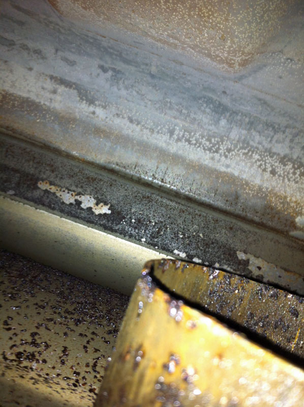

Here is a cell phone shot of the inside of the tank. What you see in the foreground is the "soup bowl", where the fuel intake sits. It looks like it might be difficult to get sealer on that without using a few gallons. It also has a 1/4" hole in the bottom (where fuel flows in), and it is important not to block that off.

In My opinion, you should not leave the cleaned tank uncoated. The original tank had a protective coating, terne, zinc or something. The cleaned tank will have no coating on the rust spots, which are in the most vulnerable areas, even if the cleaning does not remove all the original coating. Every older tank I've dealt with had little globules of water at the bottom.

sand blast it. get a sand blaster stick the nozzle in the tank and turn it on. thats what I did and it cleaned the heck out of the tank, then used POR gas tank sealer, that was after I vacuumed the sand out

My ONLY caveat, the cup in it with the hole MIGHT get plugged when you do that!!
Yes, that does concern me a bit. I plan to use an inspection mirror to make sure it doesn't get plugged.
