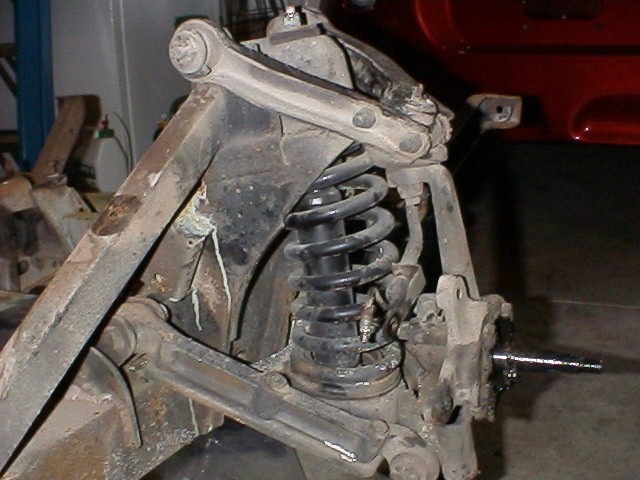

Alan does a great job describing it; here is a picture I took of my passenger side front suspension while I was dismantling the car. it shows the more curved upper control arm towards the front of the car. Hope this helps.
Mark

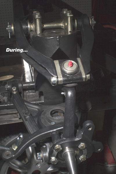

I just found a picture that might help. It's of a lefthand (driver's) side, partially assembled. I also need to correct my previous response... where I referred to 3 degrees of "camber"... that should be 3 degrees of <u>"castor"</u> instead. I was typing faster than I was thinking.
I've got three sets of front suspensions in the garage right now, none of which are marked L or R as yours are... perhaps that was done on later cars, or a previous owner or shop making a repair marked them.
Note: The upper fulcrum is a special camber-adjustable type, different from the originals I assume you are using. And there are shim spacers on either side of the ball joint (to fine tune castor), plus the ends of the control arms have been re-shaped a little to give clearance for wider wheels along with the negative camber that's been set up on this particular car.
Hope this helps...

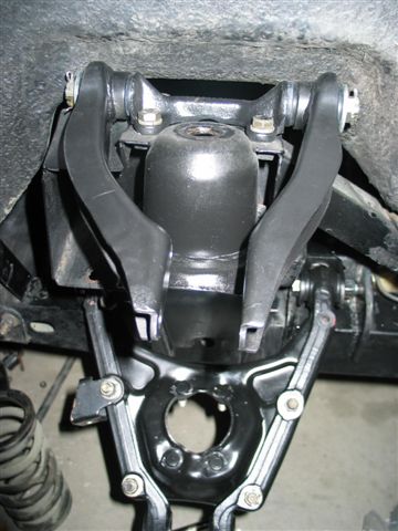

Attached is a picture of the way I've got the left side set up. Appears to "tilt" toward the back slightly, and that upper wishbone has an "L" on top!

Mark_Gibson
Re: Frt Suspension rebuild - picture & correction
Bill,
I'd agree, you've got that correct! Good luck...
