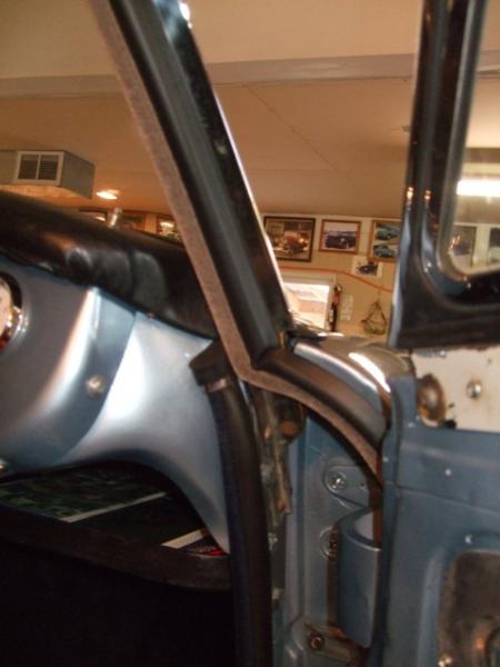

With the door seals, I've seen some cars where the door seals run up the inside the B pillar, and then are capped at the top of the door opening. On other cars, I have seen the door seal material continue past the top of the door frame and then continue to run along the top of the rear inside panel (my car is a BJ7, so it has the recess for the folding top). I am unclear on which is correct.

The door seal should run up and onto the panel covering the top recess where the springs are. It should end with part # 240-530 "CLIP-door seal end" in the Moss Motors catalog.

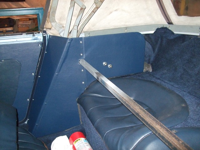

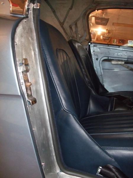

Bill, I agree completely with DerekJ and Bob. I just wanted to add that I believe the best source for the door seals is McGreagor in Canada. His are the exact copy of originals and of unquestionable quality. I originally tried to fit other products from other sources and had unbelievable problems. Finally threw everything out and bought everything from McGreagor. My car is far from original but I would have run the furflex over the top edge of the inner panel if i knew it was the correct way at the time. But I cut it too short before I found out. My aluminum finisher panels were bent up, tore up, and painted black when I got the car. So I hammered them straight, stripped and sanded the paint, then clear coated them to try to make them do.
