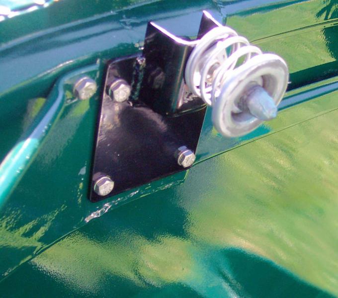

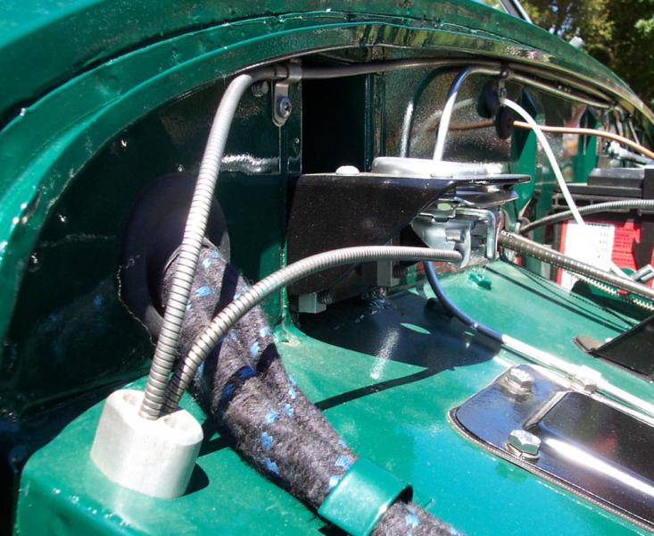

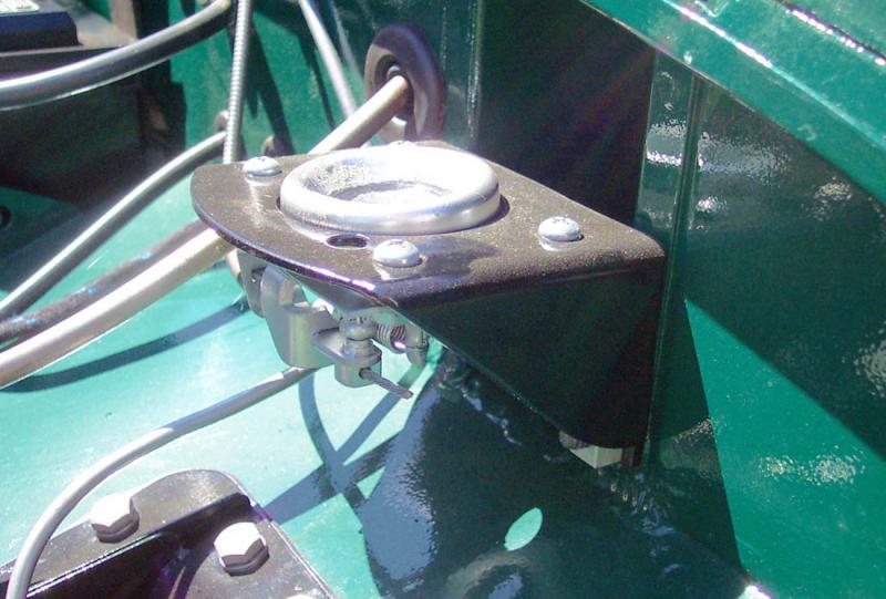

Attached are photos of the latch I mentioned.
Anyone know about this? Looks like a very nifty system. I'd like to find the owner or anyone who might have knowledge of this. Bugeye_Latch_Bonnet.jpgBugeye_Latch_FW_small.jpgBugeye_Latch_FW_top.jpgBugeye_Latch_Release_Cable.jpg

That is really cool I just couldn't take all the anxiety of pulling the cable maybe this time maybe not ?
your not sticking thru the grill on that one.

SD, Thanks that's my reticence as well, be great to get a system that requires no holes in panels. Just my preference no disparagement meant to those with side straps.
The photos are from a car that was at a British Car Meet in Palo Alto, CA years ago. I was hoping the owner might still be around.

Those photos were taken by a friend of mine and are also on my web site. I have pictures of the car as well, but I never saw it other than that one time, even at subsequent Palo Alto shows (of which there weren't many more). Neither of us met the owner that day as he was not around all afternoon, so neither if us were able to ask any questions.
SD, Thanks that's my reticence as well, be great to get a system that requires no holes in panels. Just my preference no disparagement meant to those with side straps.The photos are from a car that was at a British Car Meet in Palo Alto, CA years ago. I was hoping the owner might still be around.
