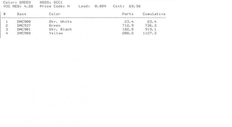

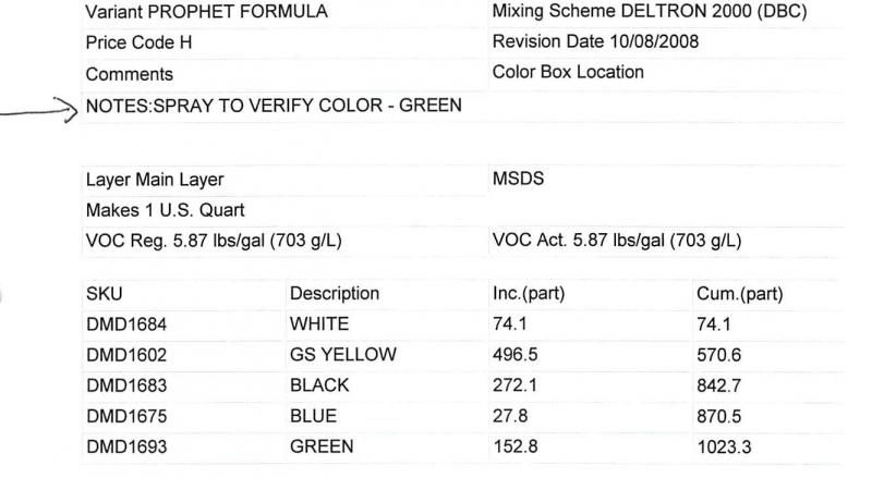

shoopal
Screen dumps of codes

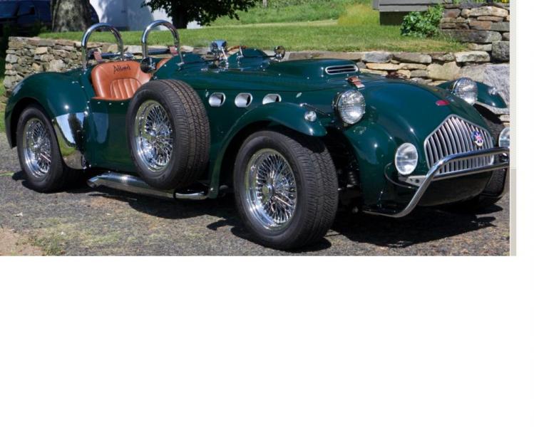

OK. Tried the samples. DCC on top, DBC on bottom
The DCC (single stage ) was the closest to the original "75". The DBC base coat/ clear coat was not quite as dark and closer to the "25" code . Also attached is the formula from the Allard car which is a pretty snazzy car but somewhere in between the other two.
I have decided to go with the DCC formula. The estimate cost is $500 / gallon which is probably way more than I need even including the interior.
