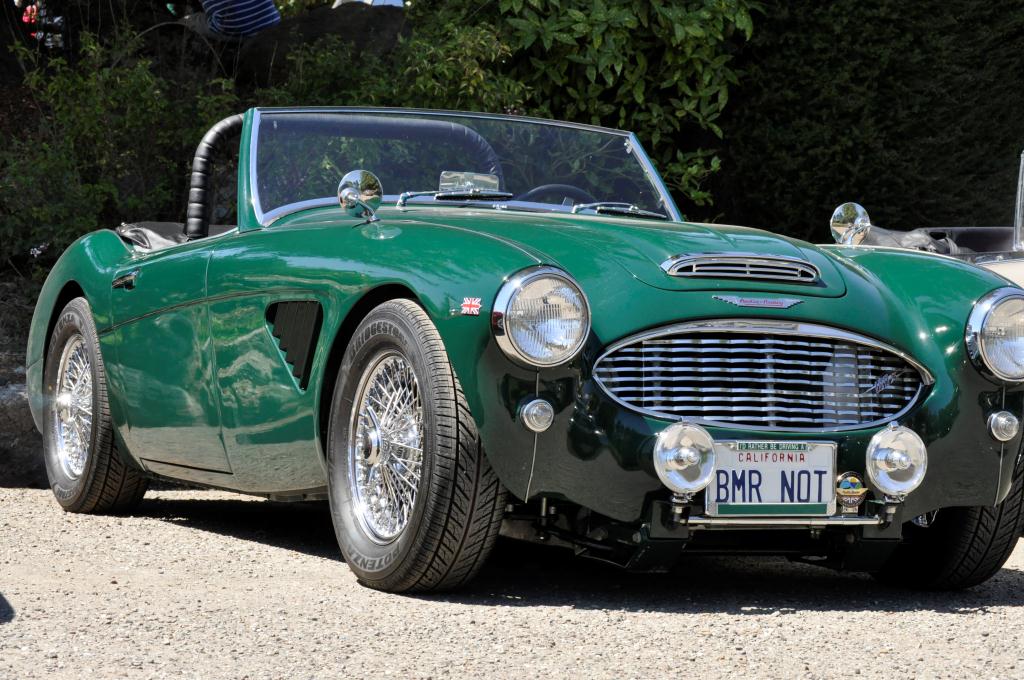

I have Bridgestone Potenza RE960AS Pole Positions in 195/65-15. I bought them at Costco and had a WW specialist mount them. I like them. Maybe not as high performance as the Avons, but the cost is a lot better.

I didn't want to go bigger than 185s for two reasons. A heavy steering wheel feel at low speeds and tire edges sticking way out beyond the front fender line.
John Turney
A heavy steering feel when parking - absolutely, but it was hard at 185s. Early BN4s have a quicker steering box than later cars.
Sticking way out - look and see if it's too much:

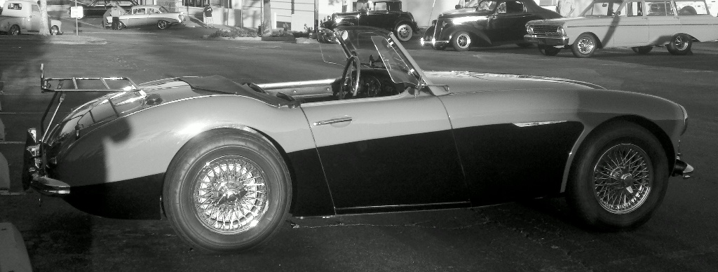

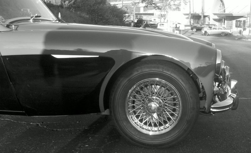

Here are Dennis Williams' Longstone 180 XASs. They ride really well and give enough additional ground clearance over my 185-70 Vredesteins that I think I'll soon go with them:
Apologies for the b&w - my phone had changed the style unbeknownst.
View attachment 32994View attachment 32995
NO apologies needed, these are beautiful photos, especially the full car shot with the classics in the background. Thanks for sharing!
