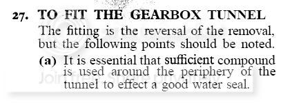

I did not have the advantage of disassembling my 60 TR3 so I don't know how the tranny tunnel is supposed to fit. After much adjusting due to a new floor panel installed by the PO, the tunnel sits above the floor by about 1/4" all around. Is there a gasket or something that fits between the tunnel and floor? The mounting plate that secures the top bows to the body is attached to the bows with what appears to be a stepped bolt or screw with a (screw driver?) slot in it and two washers so the plate and bows can rotate. Both washers are missing on one side (so a very sloppy fit) and I was wondering if this is a threaded screw to be removed or some kind of rivet. Thanks for any help and have a good day!

There is a set of gaskets for the tunnel to floor board -- or some have used other material as I recall. I think you want to assume that the next person to remove it will be you so you'll want a seal or sealant that is easy to work with later.
The plate for the top bows attaches to the body with screws (possibly 1/4 x 28) that are slotted on the driven end and pointy (to help locate the captive plate) on the other end.
As I recall, the bows themselves were riveted to the plate though if they were disassembled by the PO for painting or powder coating perhaps they were put back together with screws.

On the TR3, I don't believe the factory used gaskets there. The book says to use sealer in the joint, which is what I do. But I've seen others use the gaskets from a TR4, and they seem to work. Certainly much neater to remove! On my car, though, the floor pulls up to meet the tunnel when the bolts are tightened up, so YMMV.
Those are shouldered bolts; should come out with enough persuasion. You may be able to find wavy (aka Bellevue) washers to fit and remove a source of rattles. Many years ago, I just tied a piece of baling twine into the joint :smile:

Disassembling a car is dirty work. I prefer to buy projects that someone took apart. It is a big puzzle and a real challange without the help of the people on this list. I don't have the experience that Randall has, but three Triumphs that I have worked on needed some kind of weatherstrip under the tunnel or you will get heat and water coming into your cockpit. If you use a closed cell foam, it should not leak. I usually needed at least two sizes. 1/2 inch and perhaps 3/8. Some of the gaps are larger than others. the bolts will squish the weather stripping down.
