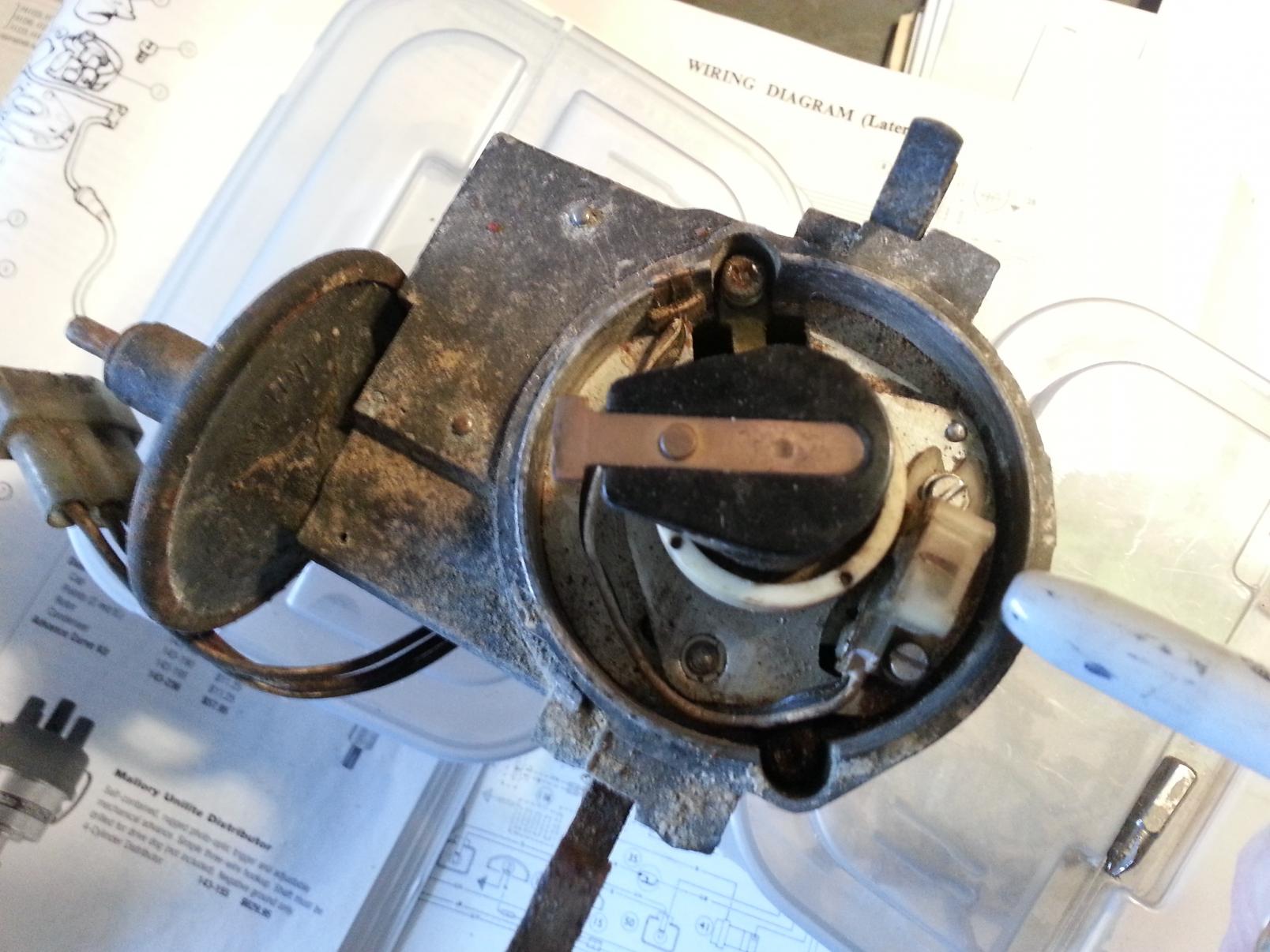

the distributor that I have looks just like the one in the Moss catalog, which says it is points. 20140316_190147[1].jpg20140316_190211[1].jpg These photos are of an older spare distributor from my car. I part in the 2nd photo I am pointing to with the marker is what I believed to be the points yesterday. I took this piece off and lightly sanded down the 3 nubs (which to me look like tiny magnets)which face the rotor. As I am typing this, I realize that I should have taken a picture of that piece where I sanded... Hopefully, these pictures will at least help clarify what type of distributor I have. If I need to get any other info for anyone or more pictures, please let me know.

Looks electronic to me!

I don't know how to say this kindly, but it's pretty evident you're lost.
Those aren't points, and should not have been filed. It's hard to say whether you have done irreparable harm, but it is clear to me that you either need the hands-on help of a knowledgeable mechanic, or to study ignition systems in some detail.
