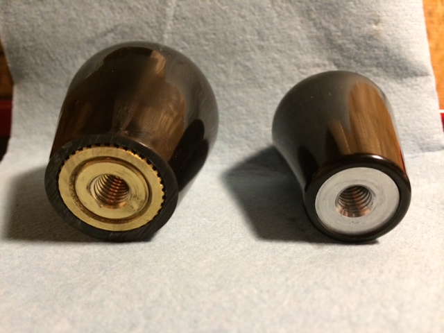

Would you please post a pic of the underside of the knobs side by side? I'm curious.
Futofab 5-speed knob on left, stock knob on right. My stock knob has a metal insert from bugeyeguy.com, never was a fan of the feel of the original rubber insert these used.

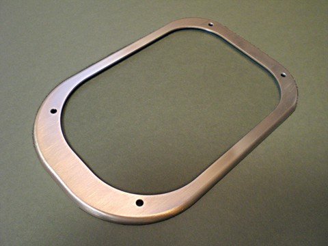

Getting the shifter to clear the metal can is a common problem. It requires re-welding or bending the shifter just right, and even slight variances in cars structure and placement of the gearbox can make it better or worse. The dogleg is worse due to the shorter mount (if you did not compensate for that).
I also make a gaiter ring (exact reproduction of one used in post '72 cars), but in aluminum. Gaiters are still available from usual suspects and many other sources. Gaiter rings elsewhere are NLA.
