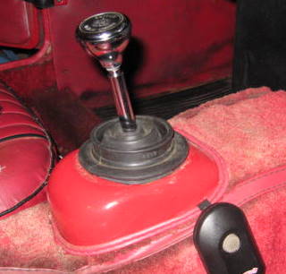

I'll start by saying that I have the MorrisService kit. The shift lever WAS modified with the offset to the side, but it wasn't enough front to back sooooo..
I took the shifter can to work (where metal working equipment is available. We cut 1" of height out of the can and put the mounting ring back on. 1" is all of the straight on the side of the can. Then I had the hole filled in completely, then put in a new hole moving it forward in the can as much as possible, a little over 5/8". The hole put in was a larger hole than stock, on purpose, because I had obtained the shifter boot from a Healey 100-6.
When anyone looks, they see the larger Healey rubber boot, and can tell that "something" is ... different, but no one yet has been able to put tell the can has been lowered, let alone that the hole has been moved. .. I'll try to get a pic..
