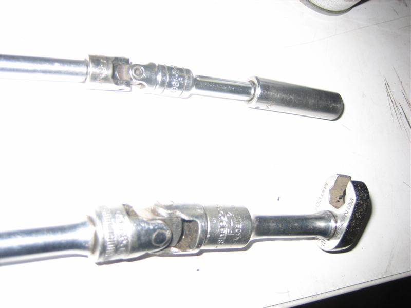

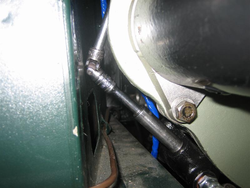

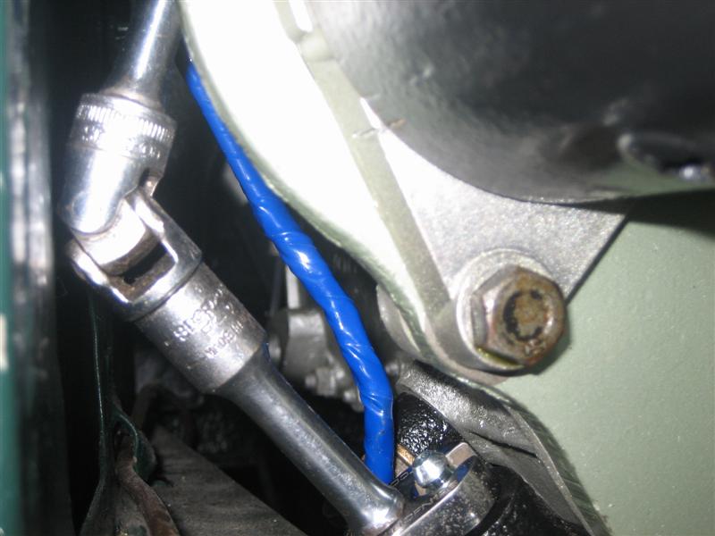

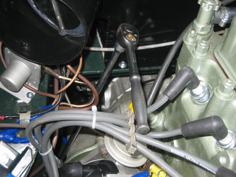

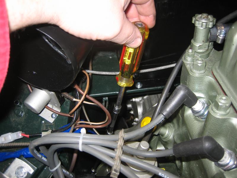

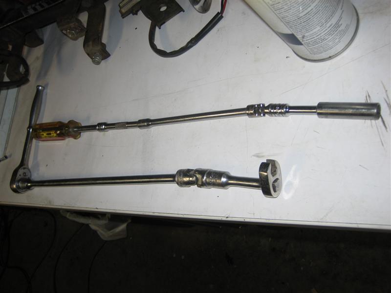

I prefer to use a pressure bleeder. Wrench size depends on the slave, but most likely a 3/8.
Jim_Gruber
And access via port / hole in PS footwell.
tomshobby
The slave on my '76 is 7/16". I found both of these approaches quick and easy to use.
