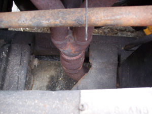

Thanks mike. Does your header come down in between the steering column and the engine or on the other side of the steering column?

Boz, here is the picture I said I would post last night. Not pretty, but it works! /bcforum/images/%%GRAEMLIN_URL%%/thumbsup.gif

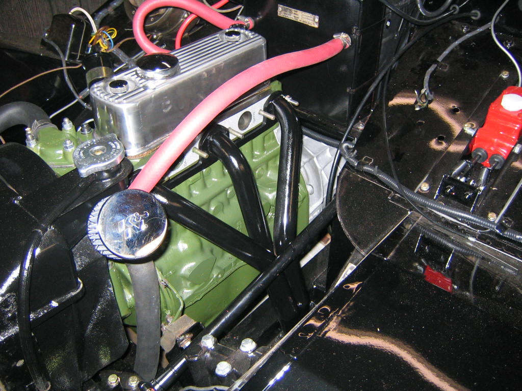

Hey Mike!! A little cut here a little cut there. It fits!!

I knew it would! Looking real nice...Keep inspiring me! /bcforum/images/%%GRAEMLIN_URL%%/thumbsup.gif
ncbugeye
Boz,
Sorry for being dense, but exactly what did you cut? I have a Bugeye with a 1275 so I may get around to an LCB one day, and would like to know the details of this small surgical operation you did.
healeyboz
healeyboz
No problem.
Under the "steering column" is an oval where the exhaust exits the engine compartment and goes under the car. The header would not slide into place because of the lack of room. I made a cut towards the rear of the oval hole and opened it up about 3 inches. This allowed for a bit of a twist of the header and I could carefully slide it into place. The head was getting caught between the hole that I cut, the steering column, and the rockers (took the valve cover off not to scratch. Once I was able to clear the rockers all went smoothly!
