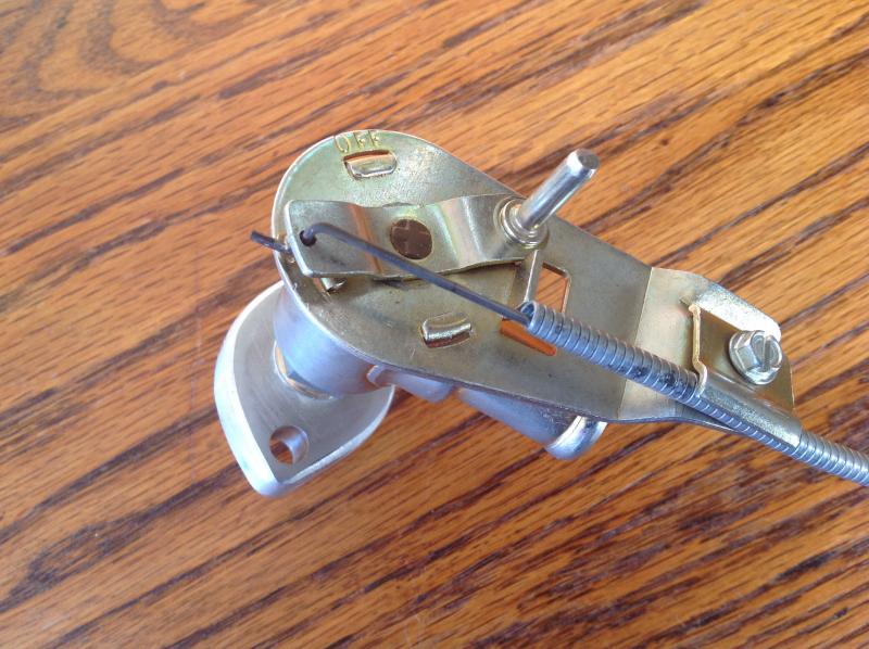

I've run into a bit of a quandary, maybe you guys can help. The PO of my car had cobbled together a hot mess of pipes for the heater. I'm replacing all of that along with a new heater valve but the adaptor is a problem. It's a 3/8" 45 degree street elbow, which I think is exactly was Moss sells as part #635-260. The problem is that I can only get it in a few turns before it hits one of the head nuts. I have not tried trimming the adaptor or head nut yet. It feels like the only way to install this is with the head off or maybe with the one nut removed, which I'm wary of doing.
Is there a better adaptor?
Ok, several options out there, but I will be using the same one I used on my MGB sans homade mounting bracket. It's 3/8" npt and should fit the head perfectly or you can go to a plumbing supply store and get a 'long' 45* elbow. There's a bit of variance between manufacturers of plumbing fittings.
Rut
Firstly - is that a split washer I see under the head nut? No lock washers there but the head nuts do need a special washer. Also (OBTW) that stud would normally have the rear engine lift bracket mounted under the washer and nut.
The elbow goes on before the head is installed. If you're not planning on removing the head right now then I see no problem with undoing and re-torqueing that one nut, especially as it is in the last sequence of the tightening order.
The other answers are more of a solution for you now. This will show you the type of fitting that came with the car. At least on a TR4A. I have fought the same problem in the past.
A photo of mine - it is a no-heater car (was dispatched to the tropics). Oddly the factory chose to retain the elbow rather than put the plug in the head.
You can also see the top portion of the engine lift bracket (which is why that stud is a bit longer).
I went ahead and notched the adaptor a bit and got it to tighten up. Thanks for all the pics.
