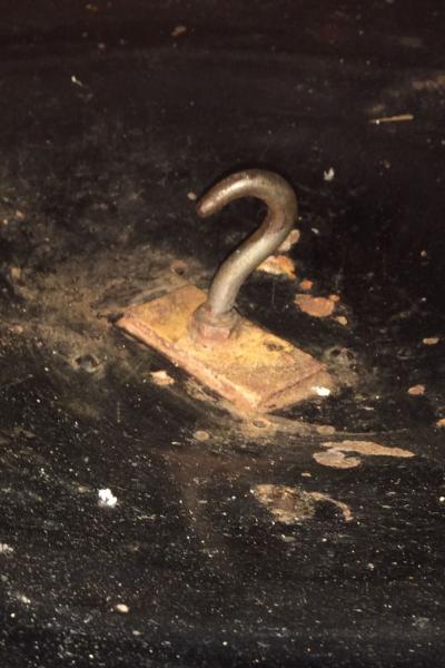

On mine (working from memory) there is a metal plate that the 'bolt' goes through. The bolt then goes through the inverted spare and catches a hook on the bottom of the boot cavity.
Found a photo...
Note how the boot lid actually holds the cover in the up position by slightly over-extending when you lift the boot lid and slipping the cover behind the cross piece. Works so slick it must have been designed to do this, yet I do not recall reading it in the owners manual.
Found a photo...
Specifically, my question is about the plate for the lower hook (the one mounted in the trunk). There is a rectangular metal plate that I assume goes inside the trunk, but I'm not 100% sure.
That sounds right but I hate to trust my memory. I have a photo of that too - but it is tantalizingly small:
Went out to the garage for a look. Mine is on the lift at the moment so can't dig into the boot but from underneath I can say -- there is no plate on the underside (just the bolt through the cross tube with some packing between the cross tube and the body)
Thanks, that helps a lot. It really only makes sense for the plate to be inside the trunk. I didn't know about the packing between the body and tube. I'll have to improvise something.
