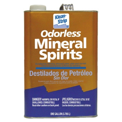

Gliderman8
This is what I use...
Ten bucks a gallon too! :eeek:
I'm w/ Billm. The cost will cause more of a stink w/ the Mrs than rig juice.
