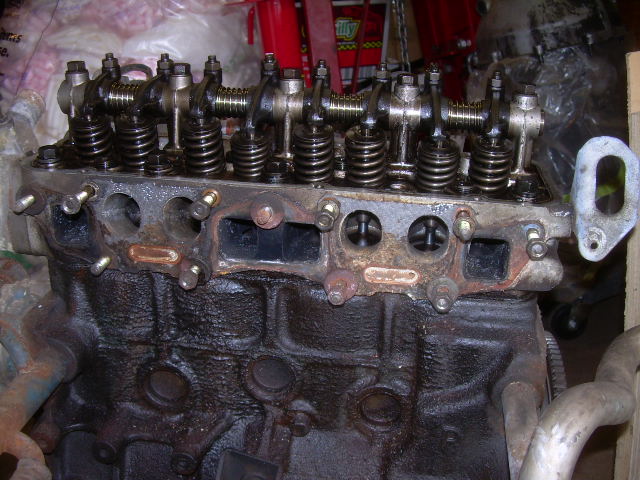

Here is a shot of that head for Kurt:

Looks allot like the 1500 head. Must be nice to have a motor you can spin w/o having to worry it's gonna go BOOM. What all does it take to put an A15 in a spridget? (just wondering)
Re: Well my Midget made it home...
Rick: A warning! Check out the 1200 datsun wiki on heads and make sure yours is oiling the valve train correctly now. Seems the GX head is for the early engines and they oil differently than the late.
Info I have shows the smog A15 datsun as only a little more powerful than the 1500 bmc motor. I believe it is considerably tougher though. As to fitting it, it is not a drop in. Not too bad in a 1500 midget though since you have the correct rad and crossmember mods already. Then it is a motor mount and intake and exhaust routing problem. Also pan clearance, Datsun trans we already are using.

Right you are, I've actually got a later head not a "true" gx.
It's the H72 and came with smog equipped cars.
Pull that crud off and plug some holes and you've got a good head that works with the later motors.
Believe me, I spend considerable time on the Datsun 1200 Wiki.

Hey Rick, what heads am I supposed to keep an eye out for? Is yours rare? I've found two 210's and was wondering if anything was worth saving off of them.

As for what to look out for.....head-wise you want closed chamber oval port heads (heart shaped chambers). The 1200GX was never imported into the US, but a few made it here anyway. Nissan sold a similar head through there performance division that will fit later engines (my Bugeye has this head). A run of the mill 210 will probably not have this head, but you never know. If you find one with twin flat top Hitachi SU clones then it is probably a GX or performance head. Grab it and you can make a few bucks.
