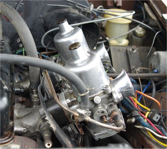

I went out and turned the key on, gas started coming out the front carb overflow.
Here are a couple pictures:

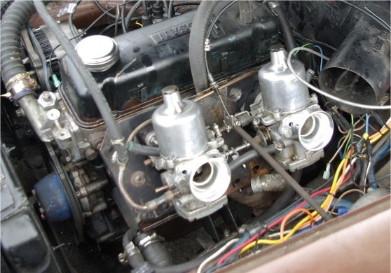

Re: Well my Midget made it home...
Another angle:
you need air filters. Su's like a little restriction- I believe it helps with the pressure differential thing. I tried running like that with just rams. Didn't work as well as when i put some filter material over the rams. Of course the gas pouring out doesn't help. Sounds like you need to make sure your floats are not stuck. and the float height is set correctly.

Yes, filters are always good.
These problems are way more than what filters will solve, it's probably more about the floats and the pressures. I'm going to see if I can find my fuel pressure regulator and hook it up, see if that's it.
Notice there is a fuel feed hose that loops around to the back carb?
I'm looking and looking and looking and not seeing it until just now, the things have a hose that goes between the two carbs at the front, supposedly to feed fuel from the front to the back carb.
So why does this fuel line from the pump go to both carbs I was wondering?
I look and look at the diagram in the book and it just hits me - there's a fuel feed hose to the front carb but the back only has "breather pipe" and "vent hose" connections on the right side - no fuel feed in over there as the fuel feed in is on the left side of that carb!!
So - what happens when you feed fuel into the carb via the 'vent tube' or the 'breather pipe'?
Whatever it is, I will bet it isn't good!!!
Going out to make it look like the book right now. Will report soon.
OMFG you have got to get yourself one of these!!!
Ok, backing up a bit...
So as you might imagine hooking up the fuel so it only goes where it should and doesn't backfeed into the VENT made everything way way better.
A little adjusting and OFF TO THE RACES!!!
