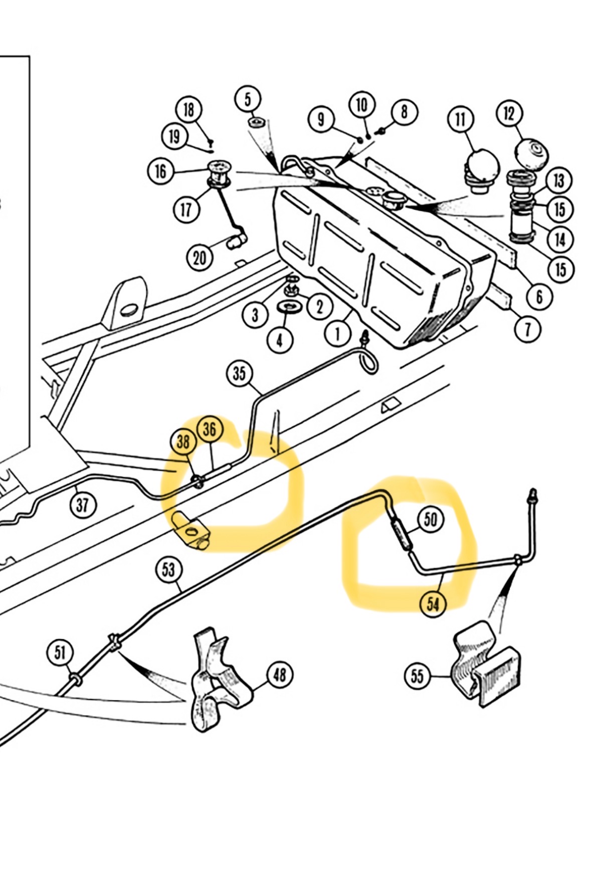

I checked the pipe work and some PO had put a rubber pipe to join the metal pipes from the tank the join was about the position of the front of the rear wheel.
See the attached plan.
Swapped it out and cured all my fuelling issues as the pipe had degraded inside. In just the shorted gap between the 2 metal pipe ends.

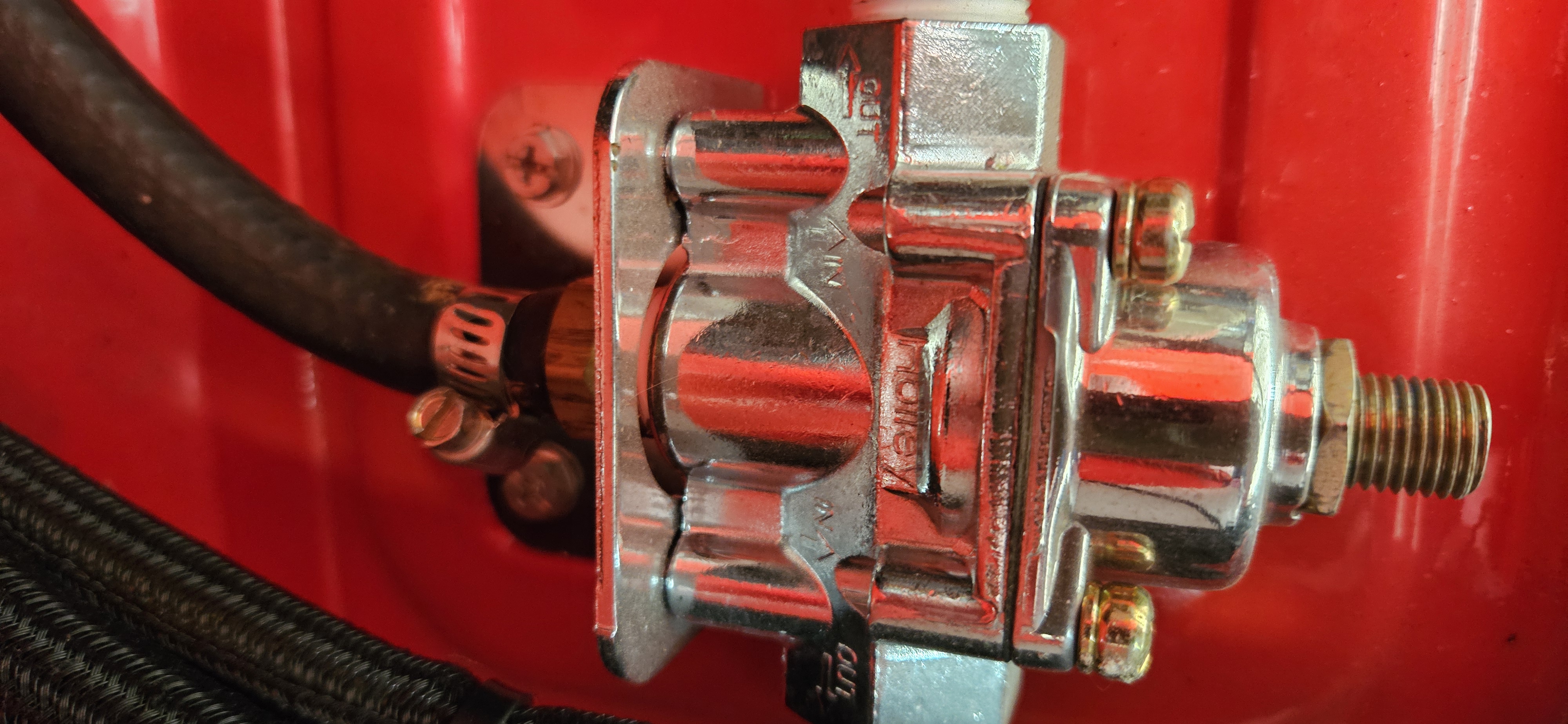

One of those great Holley regulators that barely changed from the ‘60s? If you’ve already got a good one, I sort of doubt that’s the problem, but you never know. How long have you owned the car? Can you send a pic of that regulator setup?

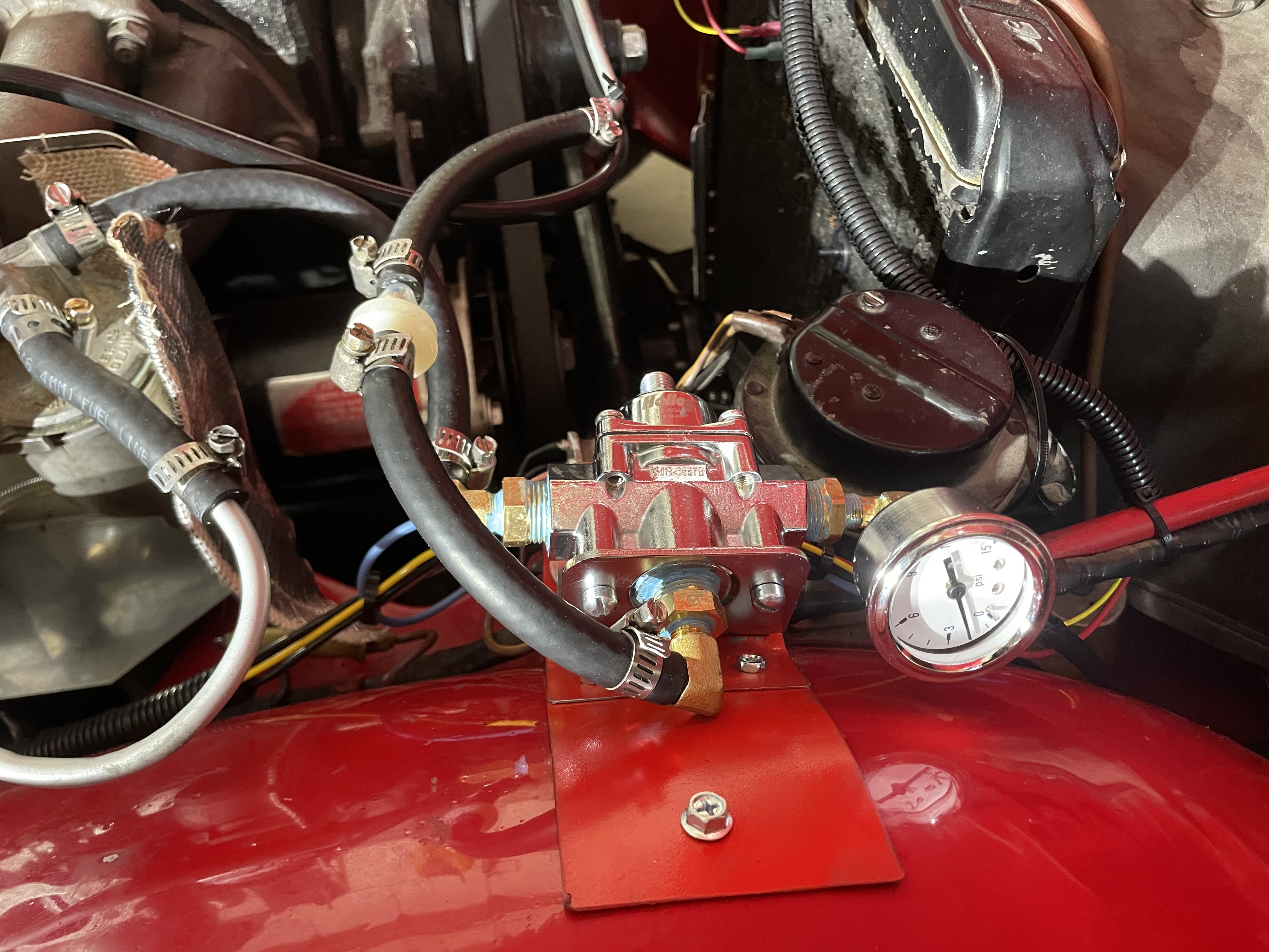

I put the fuel pressure gauge on today, from all I have been able to research it should be 2-3 psi. It read 4 psi, and I adjusted it to 3 psi. She still quit on me, but this time I took the top off the fuel bowl and it was dry. I'm thinking it could be fuel pump just quits or trash in tank. I will probably take tank out and make sure it is clean. I

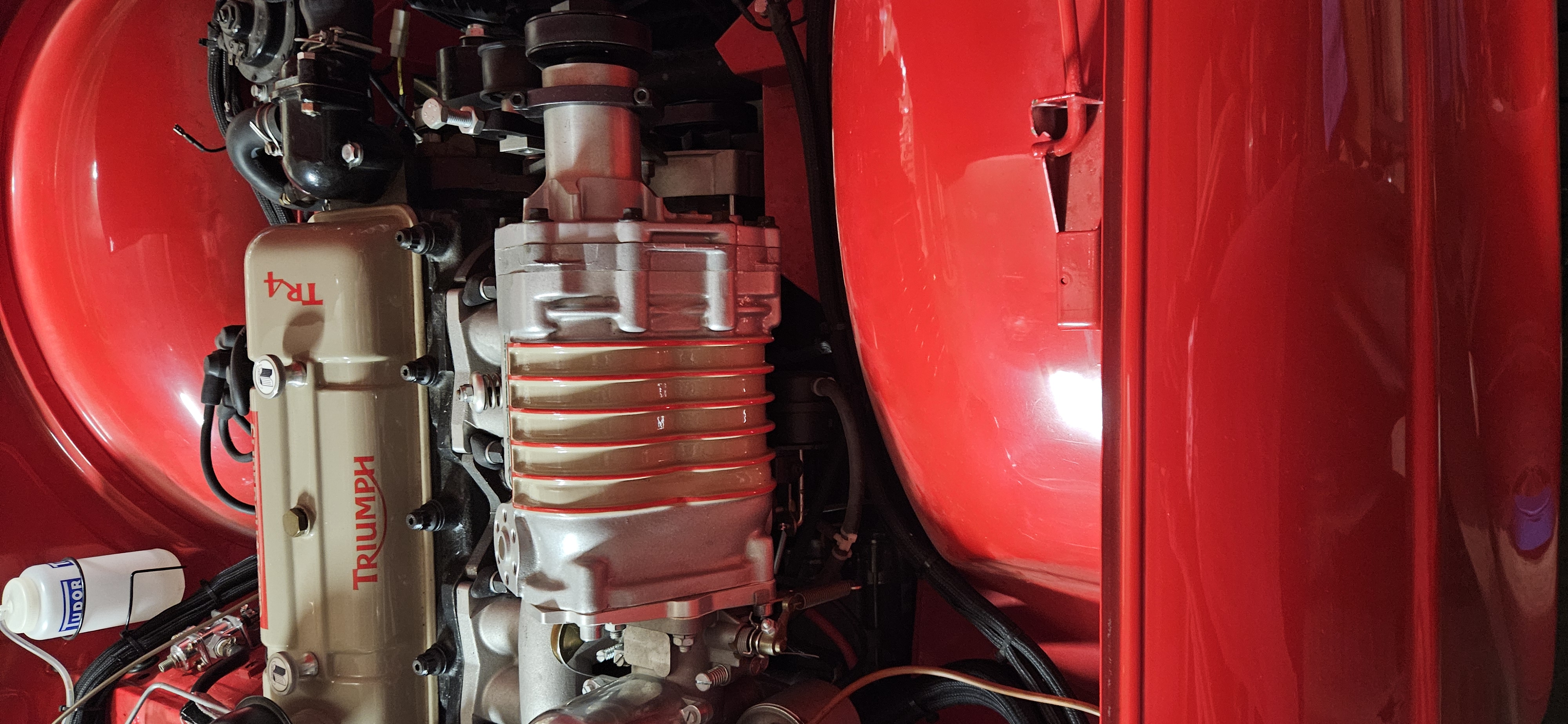

Sorry, but we might need to scratch some of the thinking here. I forgot that you have a supercharger on that vehicle.
You also have an electric fuel pump.
I’m not certain, but I think the Moss kit included your pressure regulator and also had specs that suggested 4 to 4.5 psi to effectively run a supercharger.
The combined effect of the vacuum on the supercharger plus the extra psi measured at the regulator translates, I believe, to a slightly smaller or lesser pressure at the float needles inside your float chambers.
I am certainly no expert at all on superchargers, but from what you have been saying, my guess is that something is not set properly with your supercharger specifications, or you may even have a vacuum leak somewhere in that charger kit.

FWIW, from your pic, that’s a lot of thread showing in that adjusting screw. The more thread, the lower the pressure setting. You do know that the auto shops carry a gauge that permanently fits, or screws, into the side of that Holley regulator. Mine cost me about $10. I think I sealed it in there with blue liquid teflon. The instructions say not to use teflon tape. Adjusting right there without having to set up your separate testing gauge makes it a lot easier. You may already have one attached. I couldn’t quite tell from the pic.
But that raises another thought. That’s a long run from your regulator to the carbs, and if that’s all rubber hose you could be losing pressure along the way. The stock steel line from the pump to the carbs avoided pressure loss. Not so sure long rubber lines won’t affect the physics. I wonder where you are measuring pressure. A reading way back on a rubber hose (three feet or more from the carbs) might be misleading. And a last point—are there any kinks in that rubber line. That bend from the regulator looks sharp to me.
