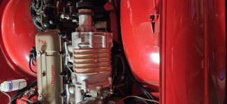

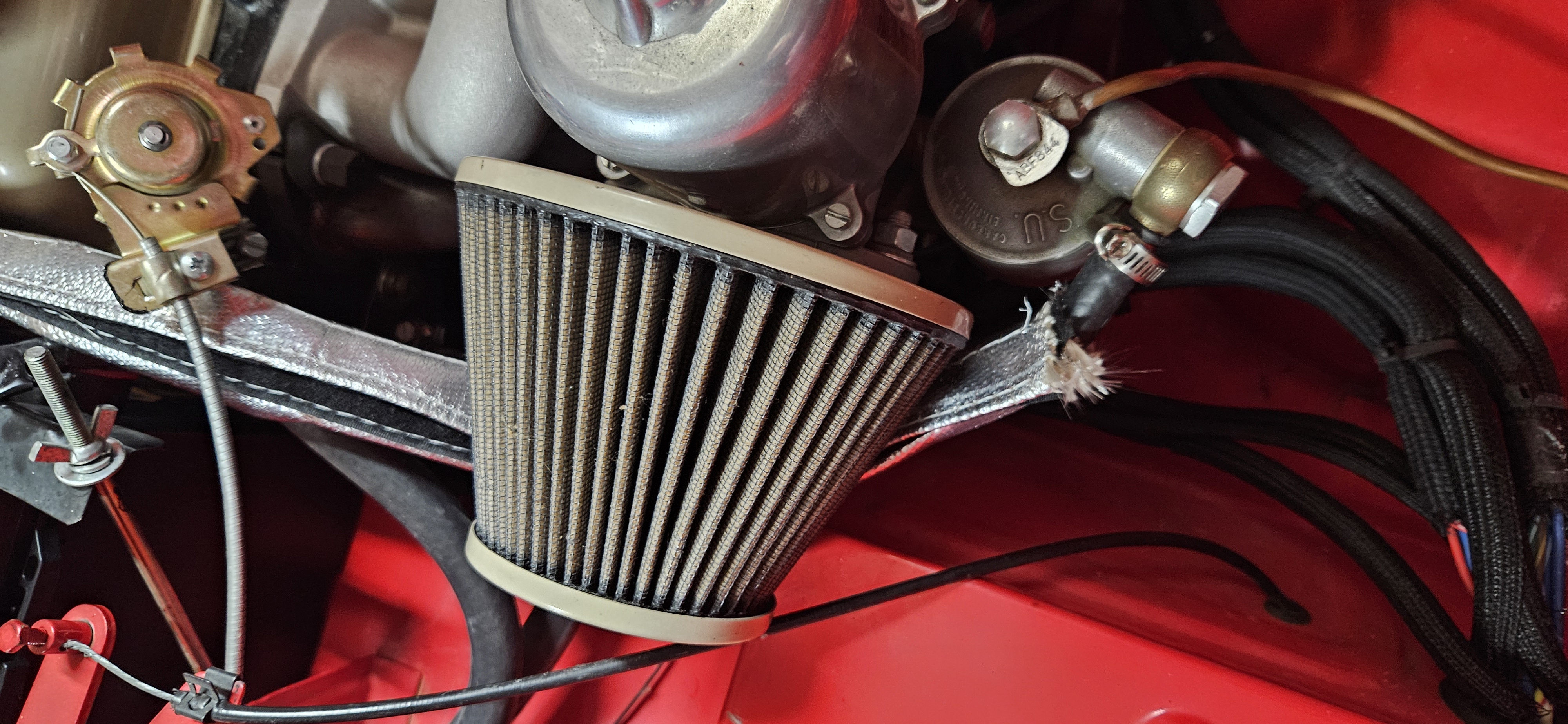

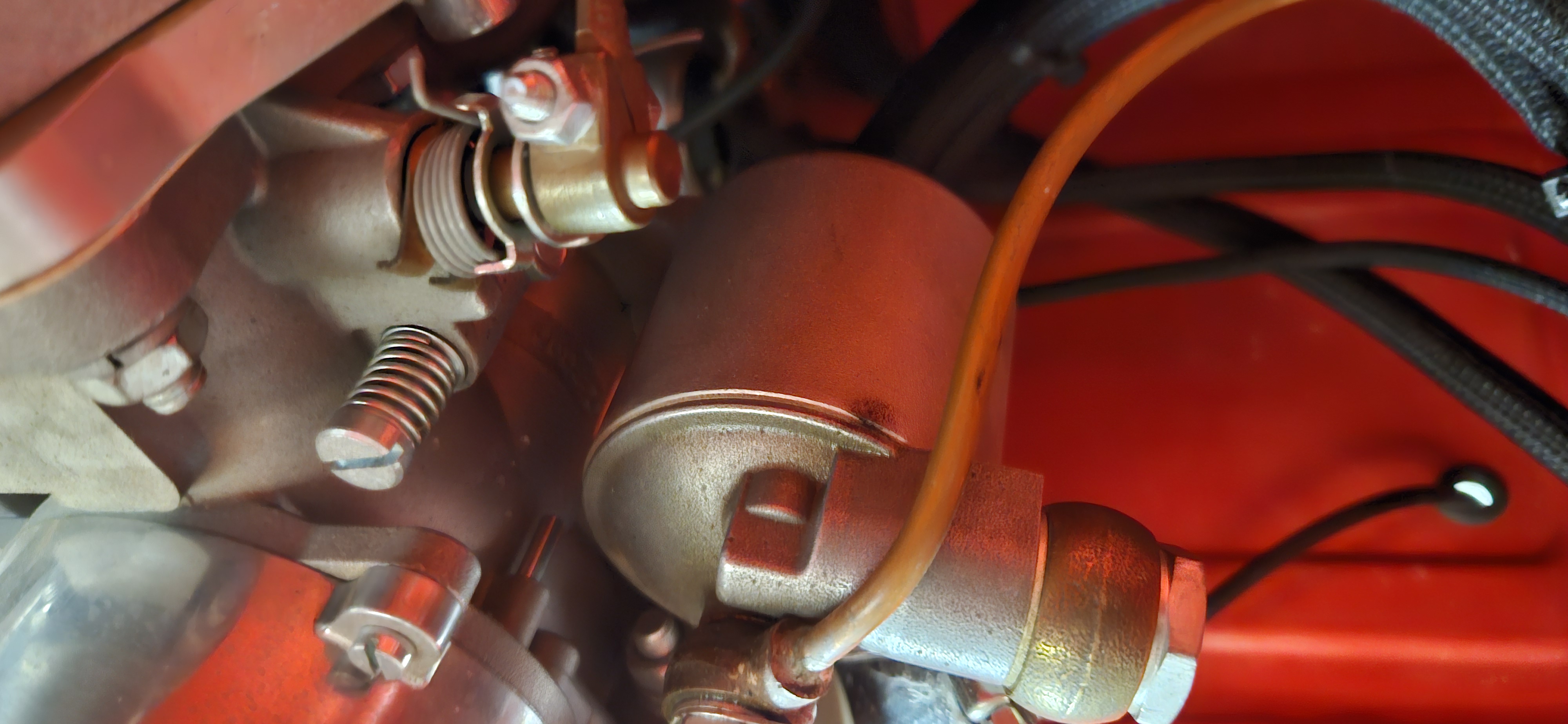

Hey,

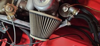

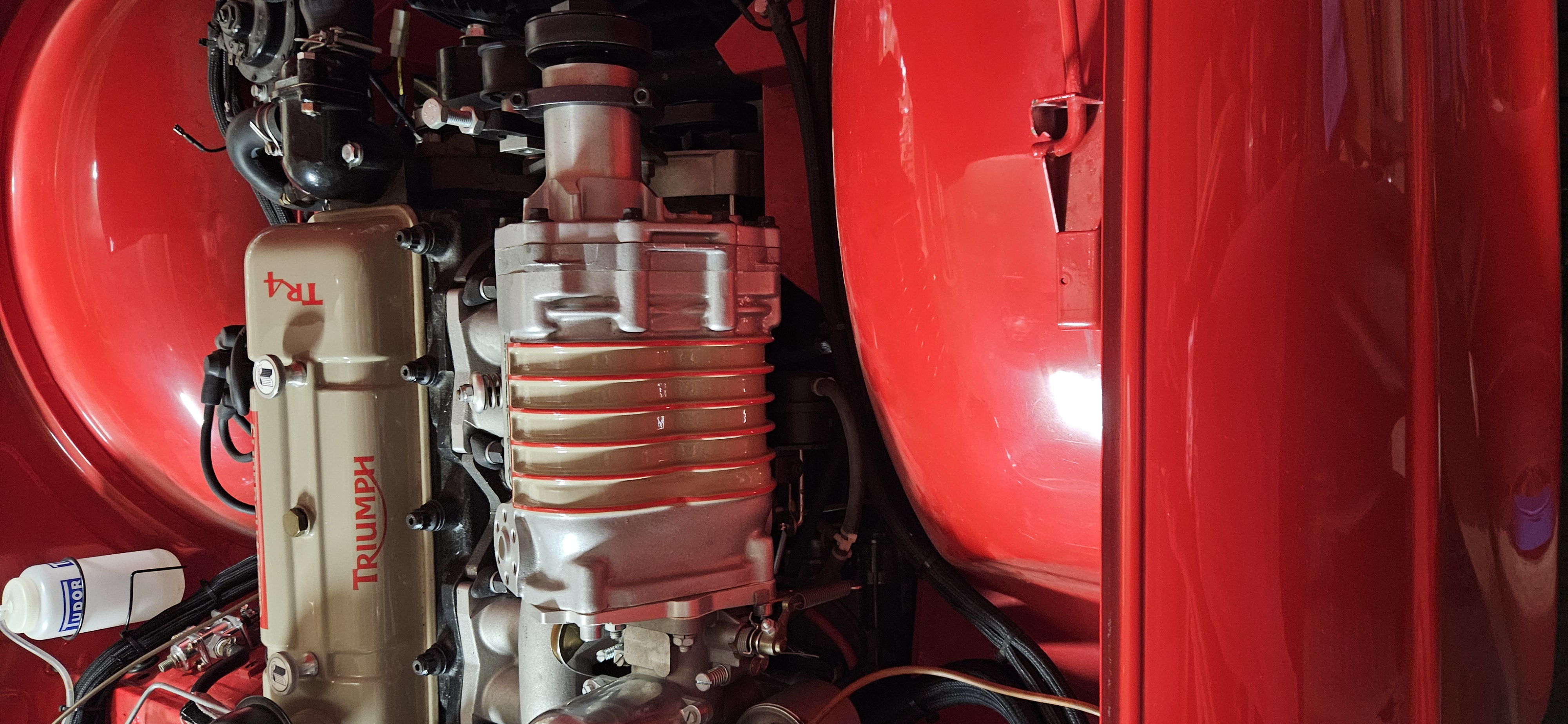

I have a 63 tr4, that stops running after driving about 3-5 miles. I let it cool off about 10-15 minutes, then it starts back up. I am wondering if it is vapor lock or???

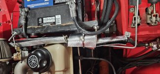

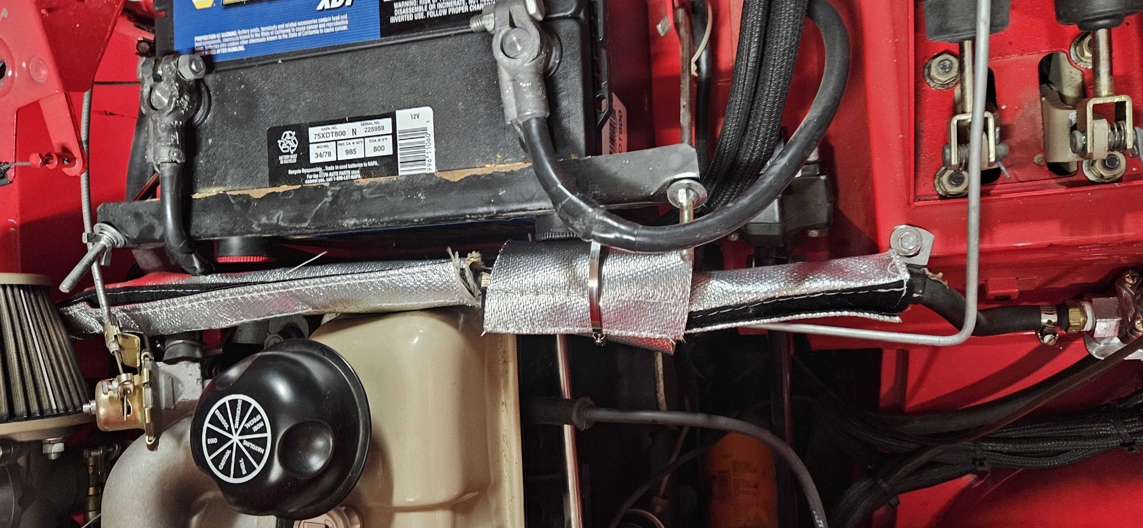

what else it might be. All input is appreciated. It has rebuilt engine with 40 miles on it. I put heat insulation around most of fuel line under the hood, same result. I am wondering if I need to put it around the float bowl. It also has a Moss supercharger don't know if that makes a difference. I will be quiet know and see what ya'll think. Yes I am in TN.
Thanks,
Jimmy Sloan
