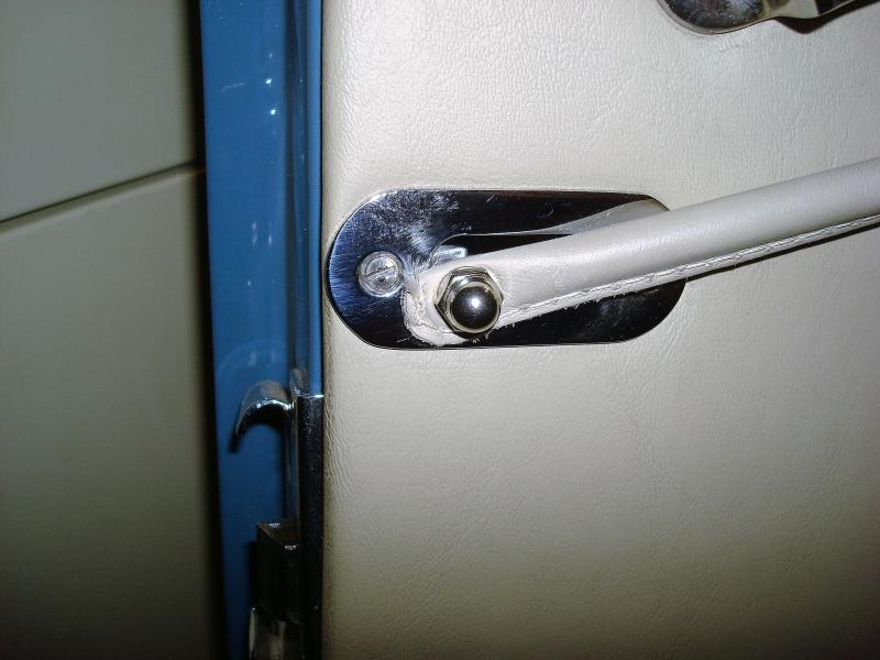

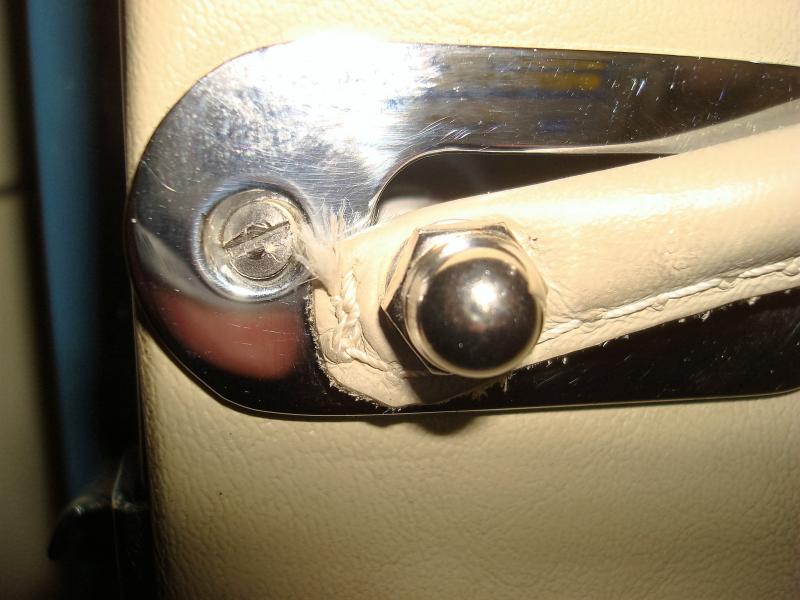

This is the way the door pull came. Does anyone have a picture of the way the factory attached the pull to the latch bolt?
I think this is what you want. If the tubing in the pull is hollow run a thin cable through it and make a loop on both the ends and crimp it. This way the leather is not stretched and eventually rip out the hole where the bolts go.

That's it...thanks! I have to assume the ends are open to run a cable through.
