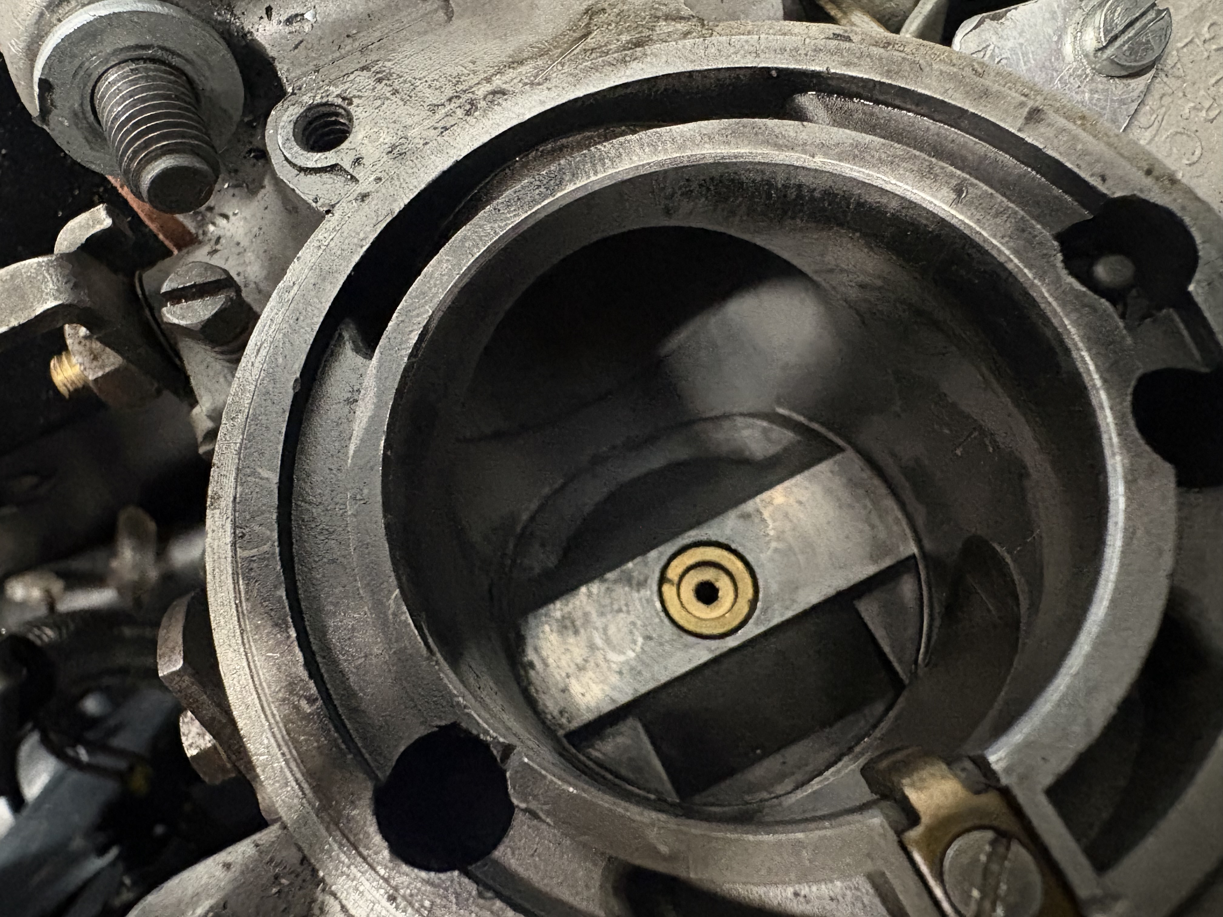

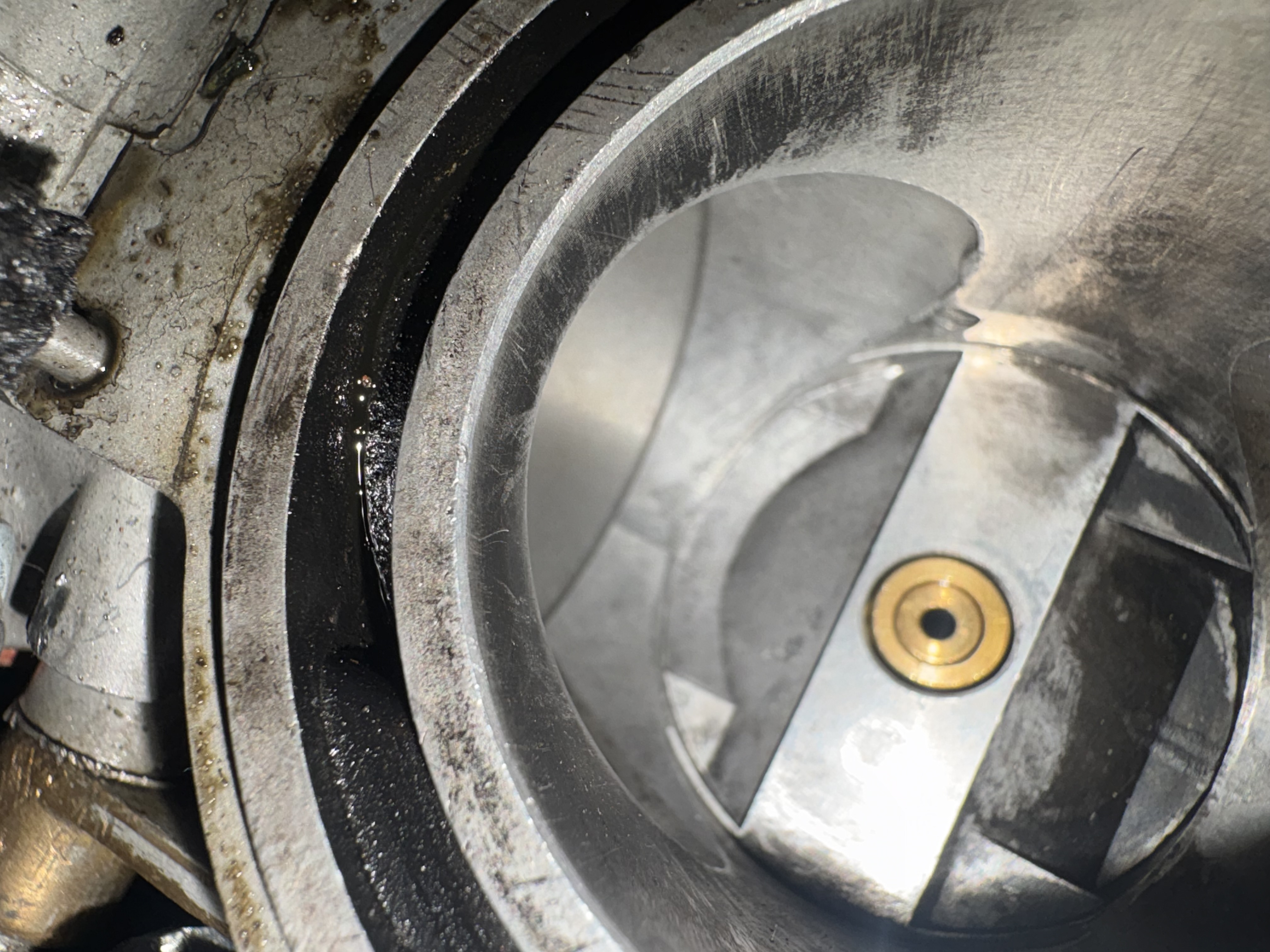

i installed a revision kit on the carbs and changed the old fuel filter with a new one. Also all fuel hoses have been replaced.
I fitted the pressure regulator and regulated back to 2 psi there was still dripping fuel from the inlet manifold drain and the mixture was ultra rich. Fuel level at bridge was not visible in jet.
All the suggestions sound good, but if you think there might be any debris in the carbs at all, you could try flushing them out. disconnect the fuel lines and run the engine until you burn all the fuel in the carbs and the engine dies. Then squirt a can of carb cleaner into the carbs and lightly tap a wrench on the bottom of the float bowls. The vibrations should free up anything sticking. You can also try blowing a little compressed air into the carbs (20lbs pressure or so). Reconnect everything, start it up and see if it improves. I had to do it twice before everything on my strombergs loosened
I disaasembled both carbs and cleaned every single part, but i will try this method just to see if it helps.
