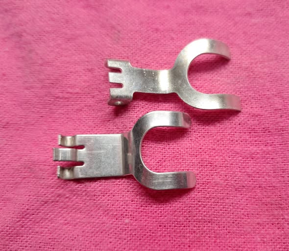

This just came through my FB scroll from 'Dr. Carburetor Alan Vinegar' and is, perhaps, germane to the discussion:
"Not all float bowl lids are the same. Most HD8s use a taller lid and the pedestals inside are taller. As a result the float forks is different as seen in the picture. The previous rebuilder did some nasty bends to the fork and using Grose jets miraculously it worked. I picked up the correct forks from Autofarm who specializes in Healey Parts."

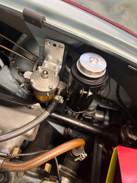

Reviewing the posts I see from #24 that you added a fuel pressure regulator which I believe you set to 2 psi and that did not help. What kind of fuel pump are you using and can you send a picture showing where/how the fuel pressure regulator is installed?
This topic/problem sure has legs!
Walter--
The pump is a Pierburg 06t289. Attached you can find a picture of the Filter King regulator installed and set at 2Psi
Walter--
At this point if this were my car I would remove the Pierburg fuel pump and install an SU.
In any case I hope you eventually get this problem solved and when you do let us know what was the issue and the fix.
