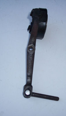

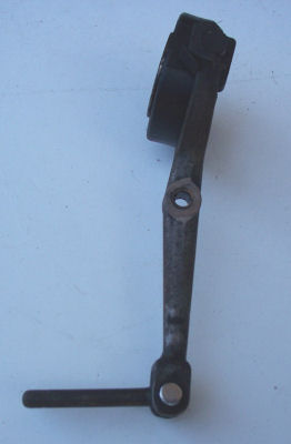

Jack with the TO problem you are having, besides the difference in length of push-rods, there are two or three different forks available for the TO bearing! Before going even longer with a push-rod, I would check out a fork that would move the bearing up closer to the press. plate!! Also check that the fork you have is installed correctly and not backwards!!

Jack in the pics above, 1st pic is correct, 2nd lever is backward and in third pic 1275 (ribbed case) fork on left and 948 (smooth case) fork on right! Hope it helps!! Of course you have made no changes so I guess that is all moot!

Something I will indeed check with the pullout this week. Thanks.
Hump in the lever goes away from the engine.
