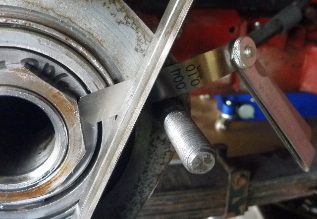

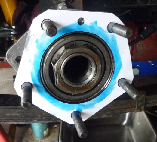

Followup - today I measured the protrusion of the bearing spacer beyond the face of the bearing carrier at .004". The new Moss gasket had compressed down from .014" to .010" - that leaves the spacer rattling in .006" of extra space. I replaced the Moss gasket with a homemade one at .005" thickness - it should compress down so the bearing spacer is tightly clamped metal-to-metal by the lug nuts as it's supposed to be according to the manual.

This should prevent further bearing spinning.
