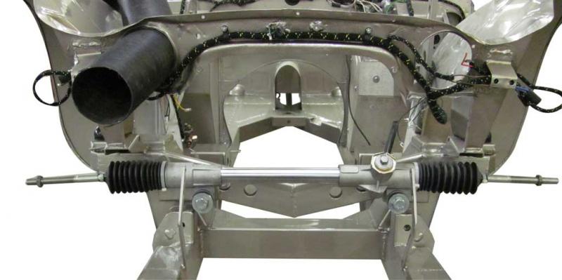

The frame brackets are for a steering rack. In addition to the brackets, the spindle arms get reprofiled and the rad recorded with an electric fan and mounted at a slight angle to accommodate.
Ahh. I had never even considered that, but of course, I now recall you mentioning it when first discussing the Jule frame (I mostly took away from that post how you said Martin wouldn't be doing the substructures anymore, due to health issues__making me wonder how much longer I can keep doing what I do...).

One part of the 'Healey Feel' most of us, I think, could do without is the slop in the steering, so R&P would be great. I see the Jule's shock plates are fixed; any idea what camber and caster Martin dialed-in?
