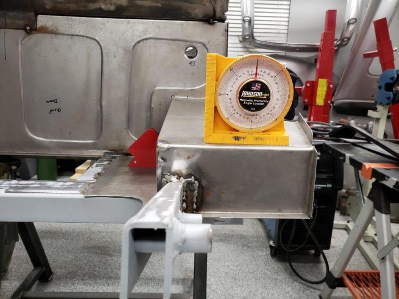

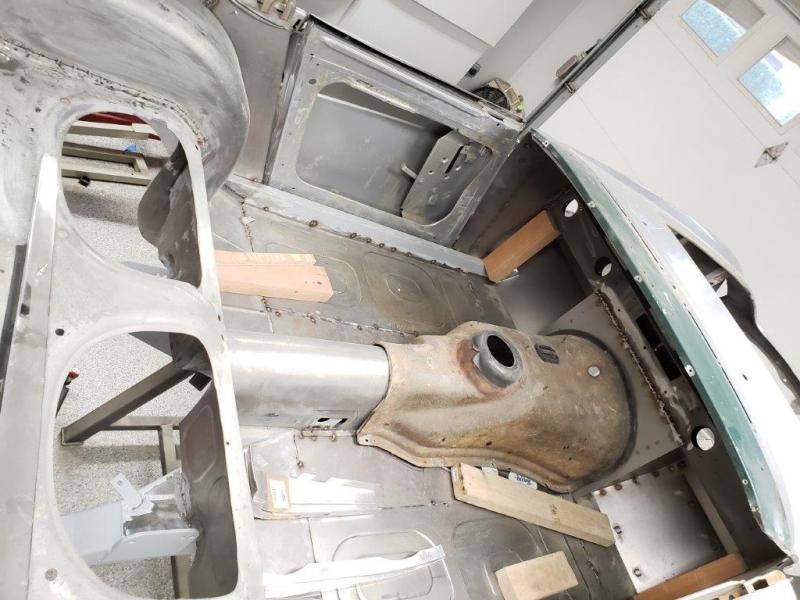

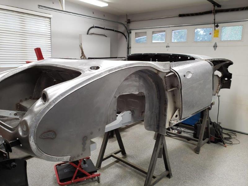

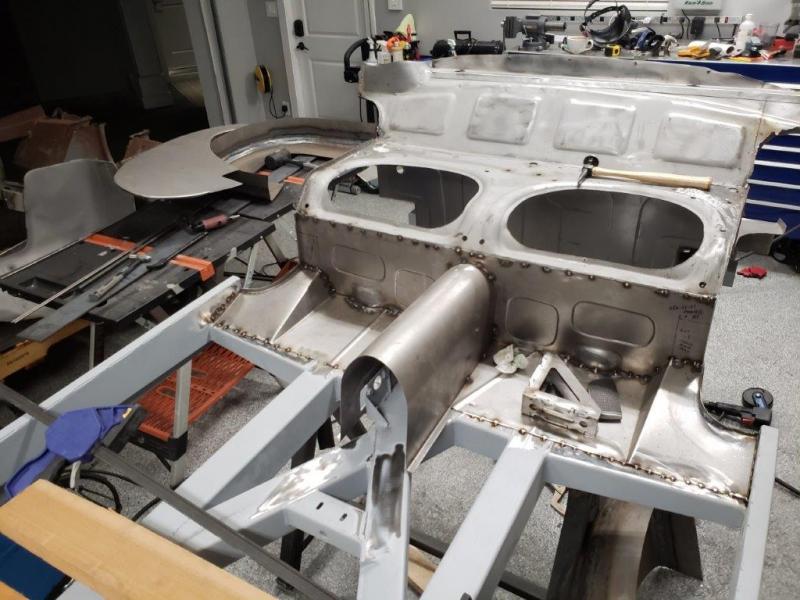

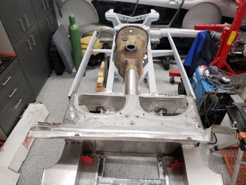

Okay, time for a few photos. I have begun building the superstructure. So nice to be past the greasy / rusty work and on to this phase. Now it feels like each step brings it closer to the road rather than dissassembling!

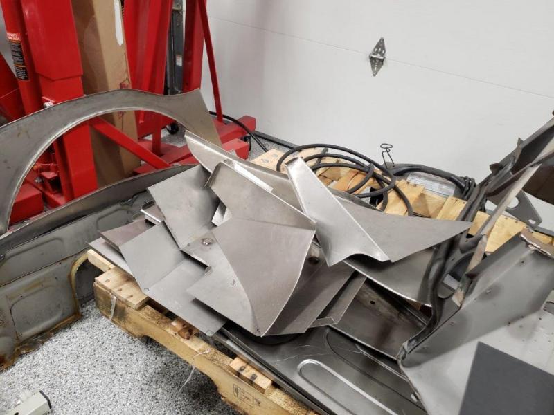

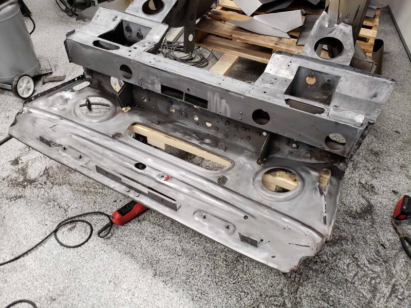

Finally ready to start replacing the sheet metal on the front structure. It was a lot of work removing the old sheet metal and preping!

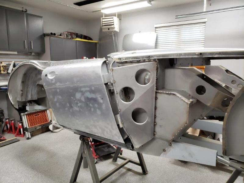

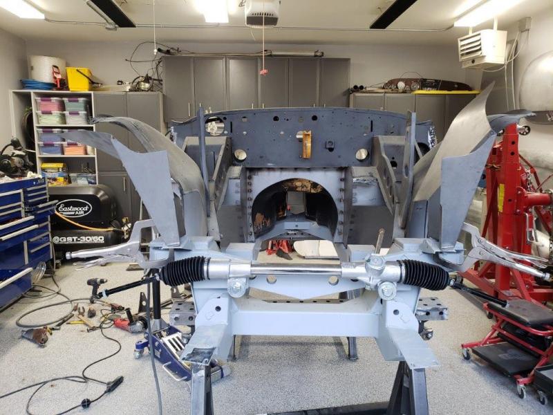

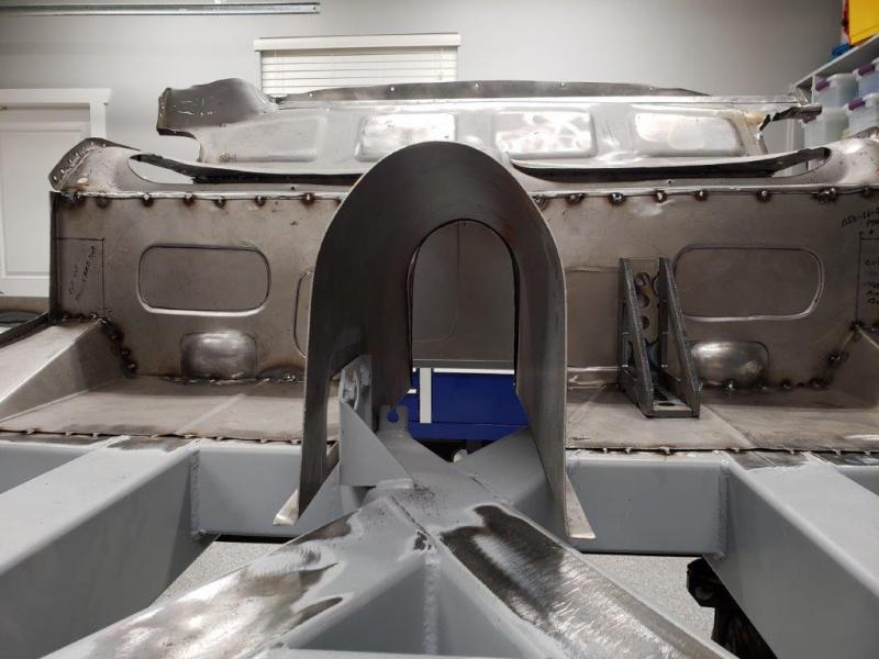

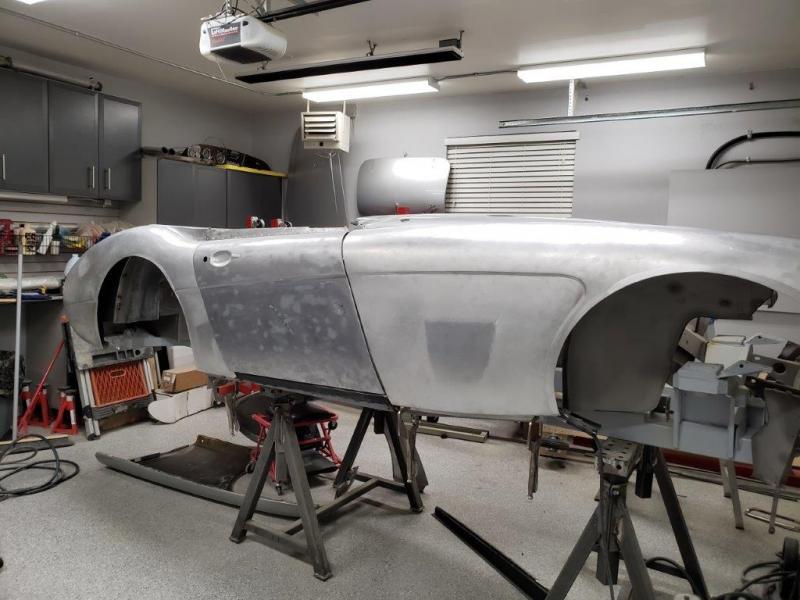

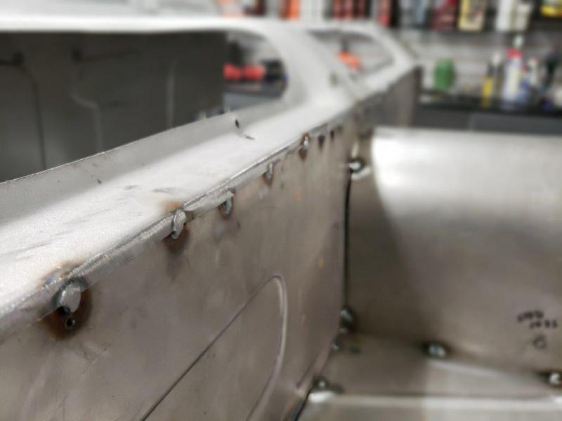

The car is coming along. I was really busy with work and other thing over the fall so did not get to spend near as much time as I wanted to on the car. That said, it`s coming along.

image.jpgLooking good. You might want to check the position of the triangular gusset between the door shut pillar and the rocker panel rear section. Usually found parallel to the dogleg of the rear wing, the leading edge in line with the outer edge of the shut pillar, just inside the flange. Some replacement parts I have seen come with that already attached to the shut pillar.
Just a thought.
Bob
