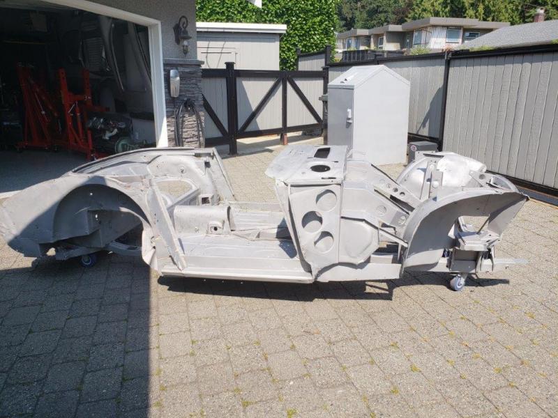

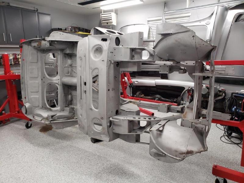

I did a new member intro a little while back and now plan to share the journey of restoring my 1967 BJ8. Thank you to every poster who has filled this forum with fantastic information. You know once you are re-reading threads for the third time it is time to get away from the computer and out into the shop....
I began taking the car apart on June 1st and am now ready to begin building. My Jule frame will arrive in about a week!

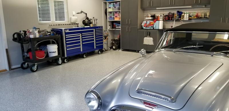

Ok Im going to ask a really dumb question .
It looks like those pretty parts in the garage are all painted and ready to install .
Were they test fitted to the new frame/superstructure assembly ?

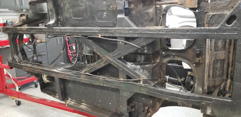

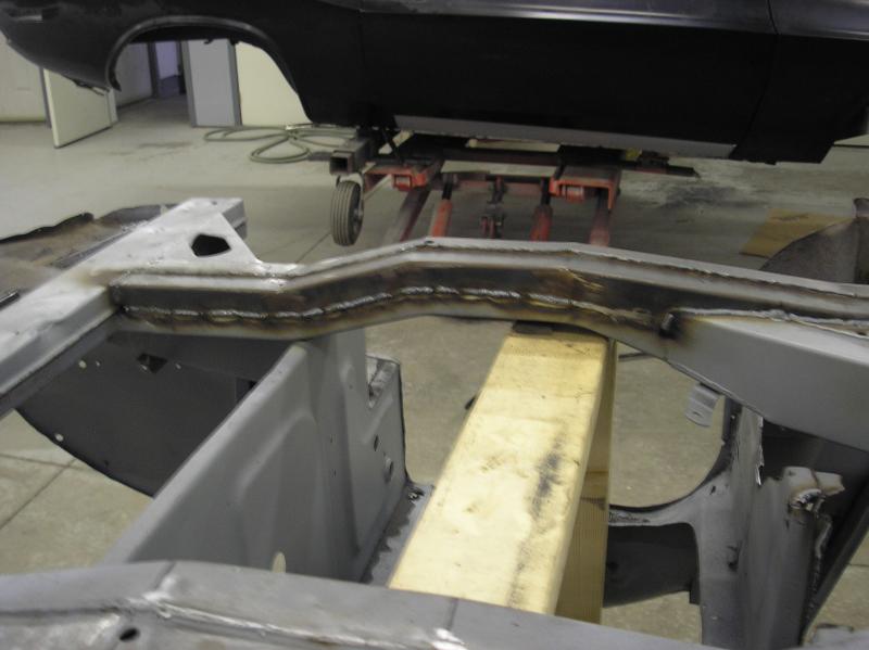

The frame doesnt look that bad to me , way better than both my Healeys after the sandblaster had revealed what the tin worm had done .
Cant help but notice the damaged front outrigger drivers side , guess someone crashed her at somepoint ?
edit closer inspection its jut the cut out for the exhaust that makes it look bent .
Frame rails can be fixed .

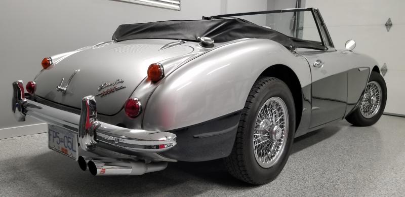

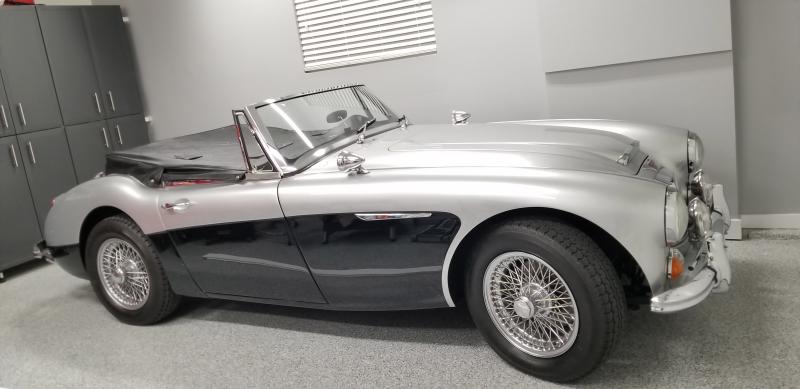

This is what the car looked like before the tear down:
Shiny on the outside....rotten on inside
Ah ok , I just was having visions of you taking parts off one car and trying to fit them to basically another car after doing paintwork and them not fitting .
So basically the car was all lipstick and fancy hair but the foundation was crumbling .

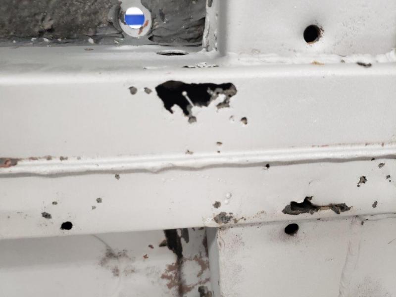

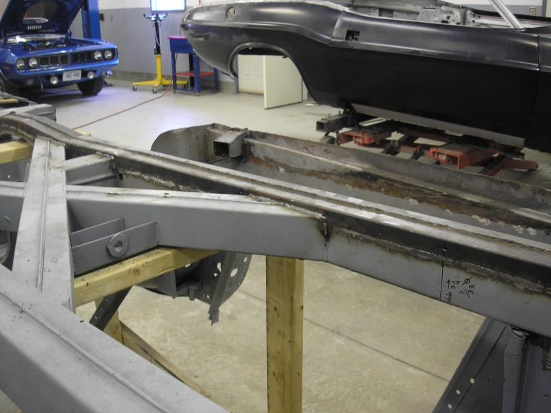

It had a rear end accident at some point, but i think the front outriggers were just rusted. It had been "restored" previously and the frame had patches welded over patches...covered by about 50 lbs of undercoating. It was also rusting from the inside out, very thin in many areas.
Here is a full set of pics that shows the extent of the frame damage: https://www.flickr.com/gp/53598796@N02/k45QC9

So you are getting the full Jule superstructure not just the frame .
I have a full Jule superstructure waiting in the wings for my 62 Tri carb project .
Unfortunately, Martin at Jule Enterprises is not doing the superstructures anymore (due to health reasons), so is only selling frames. He was able to supply me a lot of the sheet metal, but I will be redoing the superstructure myself. 90% of the inner panels will be new. I also decided to go with the steering rack they sell. I'm going to keep it "original looking", but will do the steering rack, upgraded brakes, tremac 5spd, and a fast-road engine. Someone could return it to stock if they wished in the future (except for the Jule chassis obviously)
I assume Martin did the full superstructure for your 62 at his shop?
Yes .
I delivered the original to him but once sanblasted there was very little worth slavaging . The cowl top panel and the curved end brackets for the dash and a few other minor parts , the rest went to the dump and he delivered me a new complete superstucture a couple of months later . He did use the original parts that were salvaged .
I have his upgraded rear springs as well for the car when I do it .

That is the way to go. You will have a solid, tight car when you are finished. I am doing exactly the same thing, except it will be me, not Martin supplying the labour.
FYI, Martin has done a video (4 hrs) of how to transfer/rebuild the superstructure since he is not doing it anymore. Excellent guideance on exactly how to do it. You need to be comfortable welding and fabricating, but it gives you all the measurements and things to watch for so you can do it right the first time.
