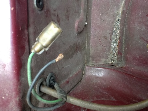

The water bottle broke loose in my 69 TR6, and I ended up losing one of the electrical connecters that connect to the washer bottle. Anyone know of a source for these? I want something that looks original. Thanks for your help.

Are you looking for a vinyl cover for a female spade connector? Both the connector and the pvc cover are available from Britishwiring.com.
See the links below. It should be for the cover you want.
https://www.britishwiring.com/3-16-Female-Spade-Terminal-Cover-p/c207.htm (3/16" cover)
https://www.britishwiring.com/1-4-Male-Spade-Terminal-Cover-p/c240.htm (1/4" cover)
https://www.britishwiring.com/3-16-Female-Spade-Terminal-p/c206.htm (3/16" terminal)
https://www.britishwiring.com/1-4-Female-Spade-Terminal-9-14-Strand-Wire-p/c221.htm
(1/4" terminal)
DNK
Kevin they'll ship just one lucar connector if needed
Just cost you more
dklawson
As Don said, they will ship any amount. However, to justify the cost of shipping, browse around and buy some spares that are always worth keeping.
For example, get some male bullet connectors and some of the female bullet couplers (single line couplers, 4-way couplers, etc). They also sell the proper Lucas wire color codes so maybe pick up some wire to fix and/or replace a bit of the wire that is bound to be hardened in your car's harness (i.e. green/blue for the temperature sending unit, white/brown for the oil pressure switch, maybe some of the red/green and such wires for the running lights and turn signals....) Browse the site. I'm sure you will find lots of interesting things worth adding to your order.
