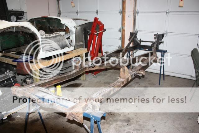

Tr3aguy
Tr3aguy
Well....first on the list is try and get the frame stripped and redone..before the body panels need to be realigned.
What is the best method for frame cleaning? I will probably just paint it...
JP
CJD
This is great...you're really moving now!
I'm biased to sand blasting for the frame. It cleans great, and leaves an etched surface that gives the paint something to bite into. Mine took 3 days to strip down myself. The blaster is reasonable...like $170 from Northern...but you do need a decent air source to run it.
Wire brushing works, but is difficult to get all the grease out of the cracks. If you don't get all the grease, the paint will not stick. Sand takes everything off.
Good luck!
John
jwolff
Hey JP,
Looks like we are finally in sync on something... I'm currently in the process of stripping and painting my frame, so far I've done just the bottom. I've been degreasing, powerwashing, using a wirewheel on my grinder, and using some phosphoric acid to etch the metal before painting it with Rust Seal (https://www.kbs-coatings.com/rustseal.html). I've heard and read that sand blasting is a better way to go, just not in my budget this time. Feel free to stop by and see how it looks... also need to talk with you about your Passat if you still have it.
Jason
M_Pied_Lourd
Hi JP,
I think that sandblasting would be the way to go if you have the financial resources to do it. As this was supposed to be a budget build for me, I decided to go the wire wheel and elbow grease route. Once that was done, a good cleaning and metal etch follow by POR15 and it should be good for another 50 years.
Good luck with yours.
Cheers,
M. Pied Lourd
mallard
Around here you can get a small frame blasted and powder coated for around $250.00. If you get your frame blasted make sure you inspect it before painting or coated for any cracks.
M_Pied_Lourd
Hi JP,
The frame was wire brushed and sanded by hand. Sprayed down with a power washer and then cleaned with POR15 marine clean a couple of times. After that, the POR15 Metal Ready was used to etch the frame. After that is rinsed off and then completely dry, the POR15 is used.
The POR15 was brushed on then followed by a couple of Coats of the POR15 Chassis Black in Semi Gloss. Fan looks great!
